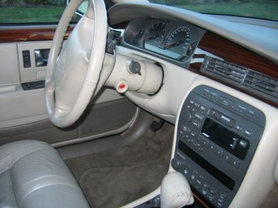

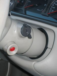

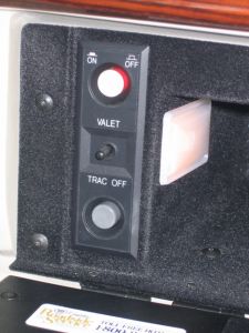

Buzzsaw, Thanks for jumping in. I can turn my key to the on position, but I don't find any buttons to push. I assumed they would be near the ignition key area but perhaps I am not familiar enough with the car to know what buttons you are referring to. It sounds like a great way to diagnos the problem, so I would like to stick with it. I have sent along some pictures of what the interior of my vehicle looks like. Perhaps that will help you in directing me to the buttons you refer to. Many thanks, douglsnicholson

the heater controls, in front of your gear shift, push off and down on your mode button, with key in the on posision
Jan 28, 2008 at 3:57 AM
DOUGLSNICHOLSON
  • 6 POSTS
Buzzsaw ... got your message. With the key in every possition possible, No codes appeard while simulateously holding in the off button and down on the mode button (on the heater controls). I assume the codes would appear in the Information Center Screen. What does that tell you, if anything? Willing to try anything to help you diagnos the problem.

send a better pic of the heater controls, codes should flash something, never seen a caddy without any codes in it, most are driver error
