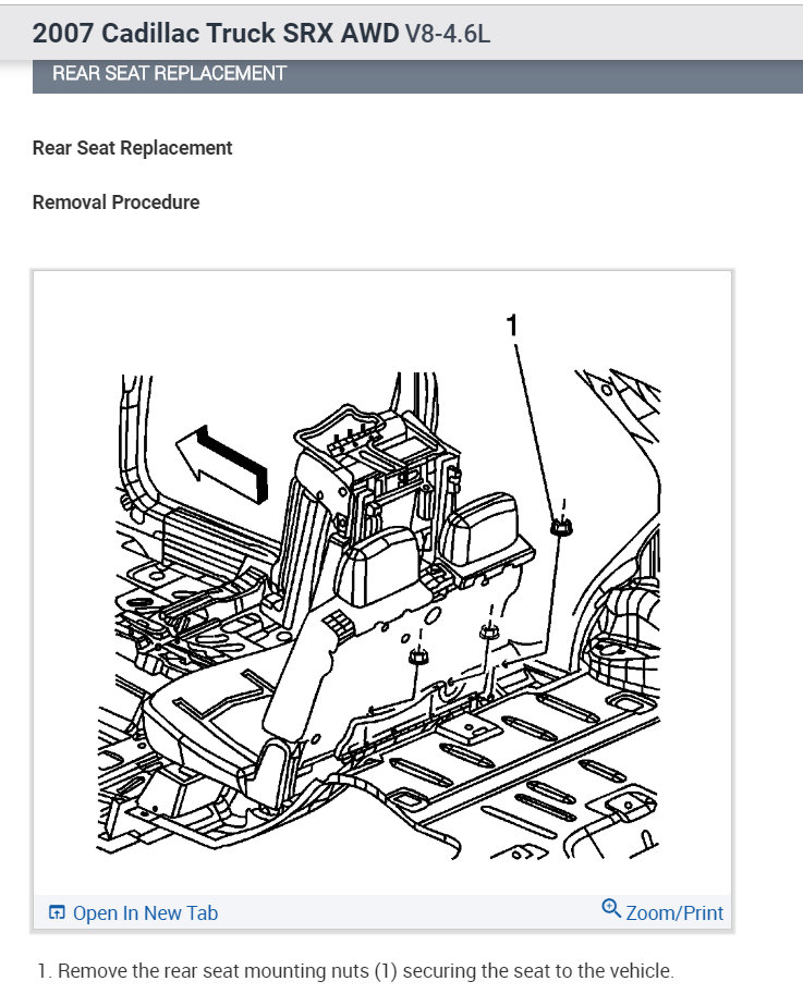

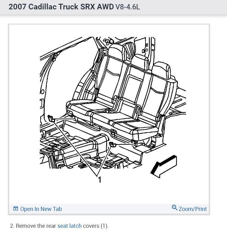

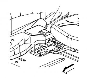

There is a procedure for rear seat #2 removal, I don't know what it is going to look like under the seat. I don't know as though you are going to gain much additional storage space, and the fuel economy increase may be slightly more than a trace amount. The seat is not going to weigh that much. Here is the procedure, for your reference. Rear Number 2 Folding Seat Replacement Removal Procedure
https://images.2carpros.com/forum/automotive_pictures/309872_1070494_1.jpg
Remove the rear seat track covers (1) from the front of the seat. Raise the seat back to the upright position.
https://images.2carpros.com/forum/automotive_pictures/309872_1070450_1.jpg
Remove the rear seat track cover (1) from the rear of the seat.
https://images.2carpros.com/forum/automotive_pictures/309872_1070403_1.jpg

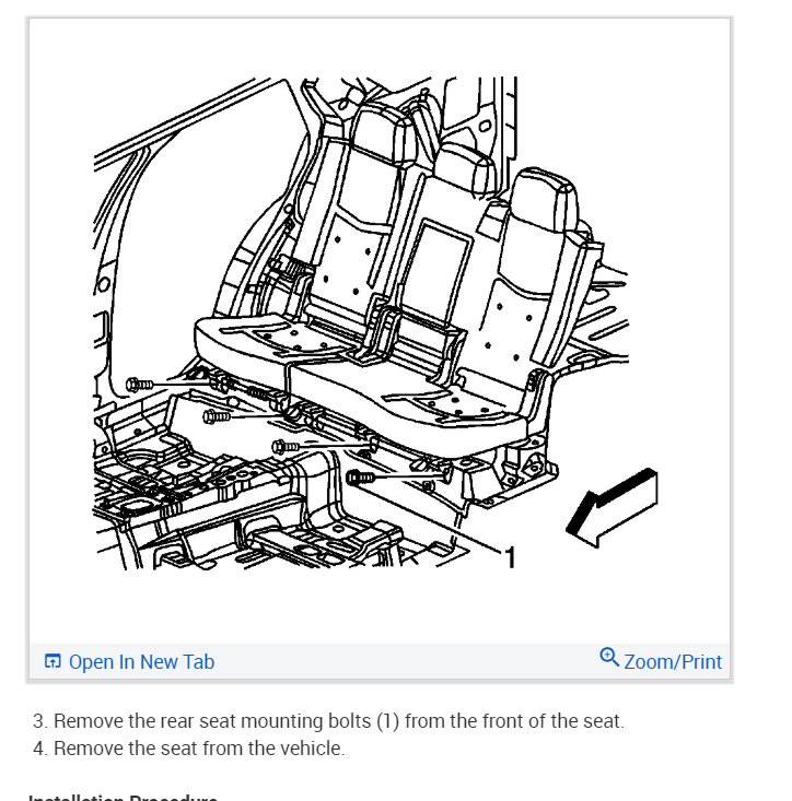

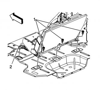

Remove the rear seat mounting bolts (1) from the rear of the seat. Disconnect the electrical connectors from the seat. Remove the seat from the vehicle. Installation Procedure
https://images.2carpros.com/forum/automotive_pictures/309872_1070489_1.jpg
Insert the hooks (1) at the front of the seat into the slots in the floor. Connect the electrical connector to the seat. Notice: Refer to Fastener Notice in the Preface section.
Install the rear seat mounting bolts (1). Tighten Tighten the mounting nuts to 45 N ·m (33 lb ft).
Install the seat track cover (1) to the rear of the seat track.
Install the rear seat track covers to the front of the seat (1). Calibrate the seat. Refer to Memory Seat Calibration .

Rear #2 is third row seat. Rear #1 would be second row. Notice in the illustration, the proximity to the storage area(what looks like a spare tire well). Whether or not this is the power folding seat, I am not 100%. I was routed too the procedure through hyperlinks from rear seat control module replacement.

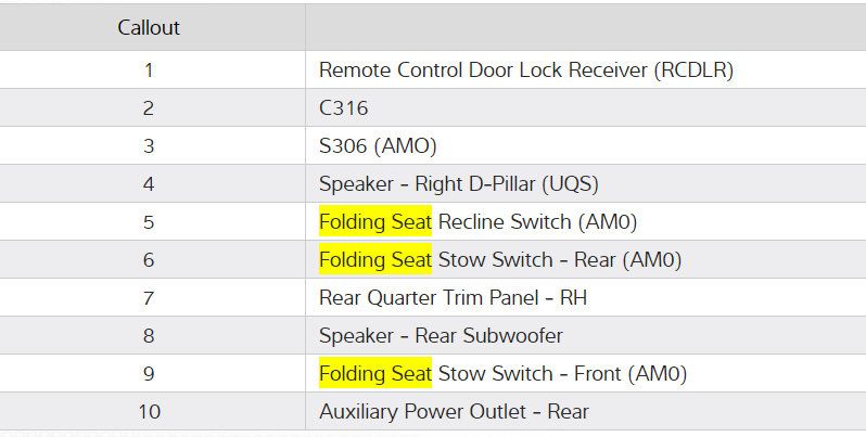

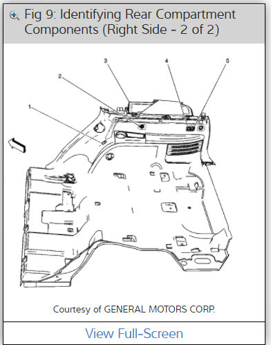

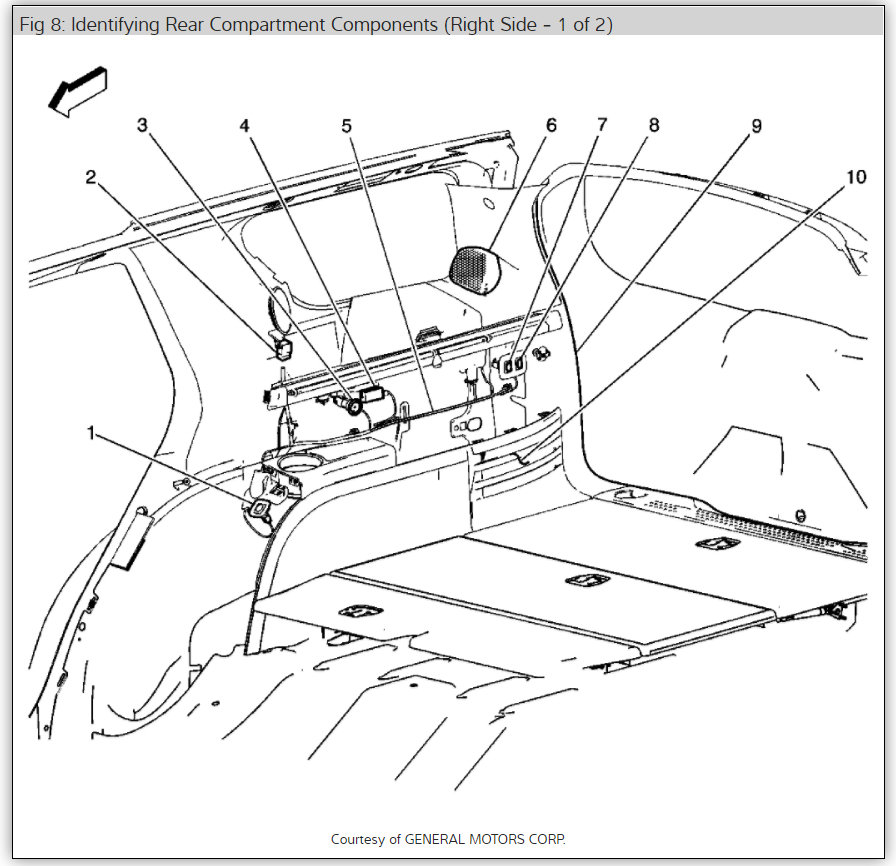

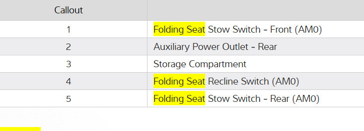

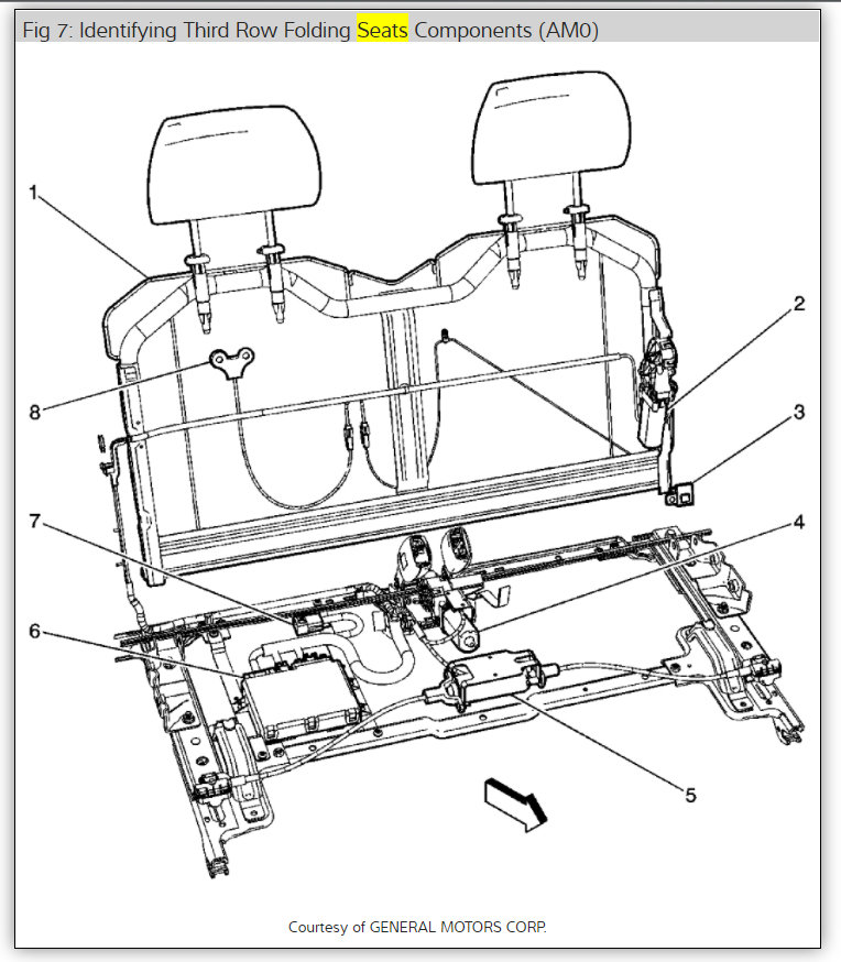

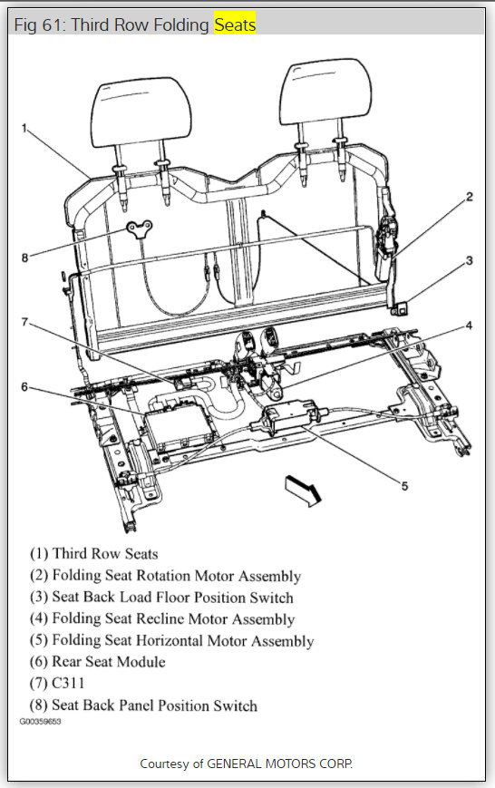

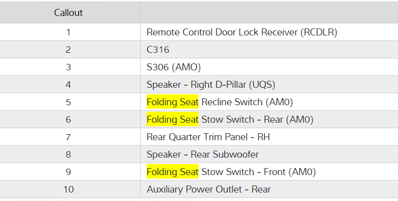

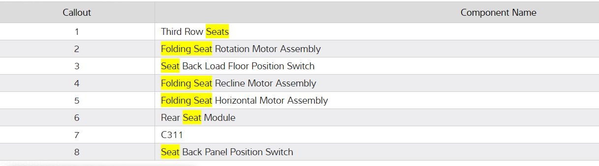

Just to clarify, by second row are you referring to the seat behind the driver seat, or the third row? Is third row, is it manual or power folding? Here are diagrams that show the complete set up so you can see just how anything works. Check out the rear seat diagrams (Below).Please let us know if you need anything else to get the problem fixed.
