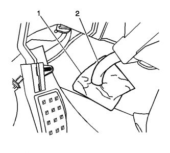

The passanger floor is wet, where is the ac drain. One person stated the center consol has to be removed, another said the carpet next to the gas petal cound be pulled back?

It is down by the pedal, at least as the picture shows. Here is the procedure for replacement, but cleaning would only be a portion of that. I would first try to position the carpet so you can access it before jumping in and removing console.
Air Conditioning Evaporator and Blower Module Drain Hose Replacement
Removal Procedure
https://www.2carpros.com/forum/automotive_pictures/309872_756222_1.jpg
Remove the center console. Refer to Front Floor Console Replacement in Instrument Panel, Gages, and Console.
Remove the rubber adhesive patch (1) from around the drain tube (2).
Open the flap in the tunnel insulator and unsnap drain fitting from the tunnel sheet metal.
Remove the HVAC module drain tube from the HVAC module.
