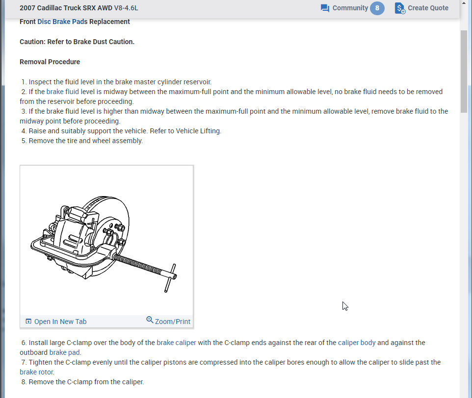

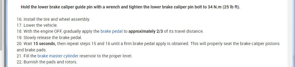

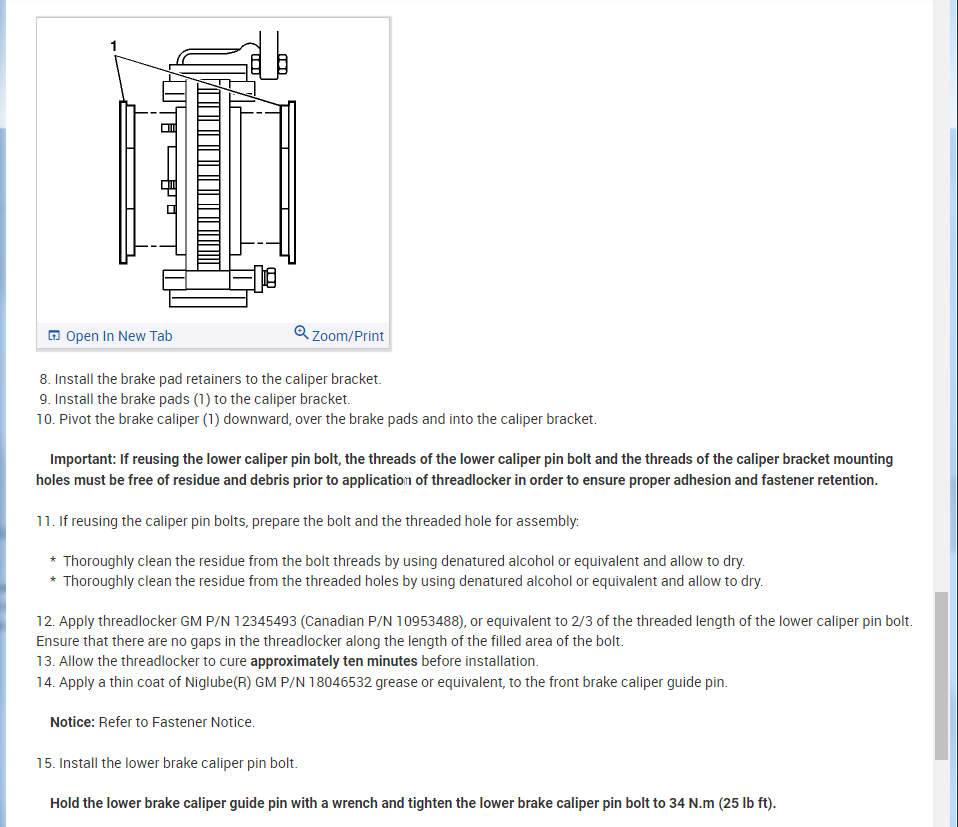

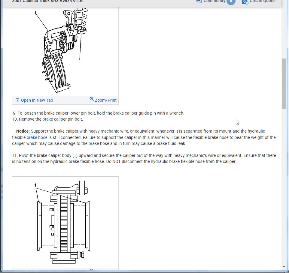

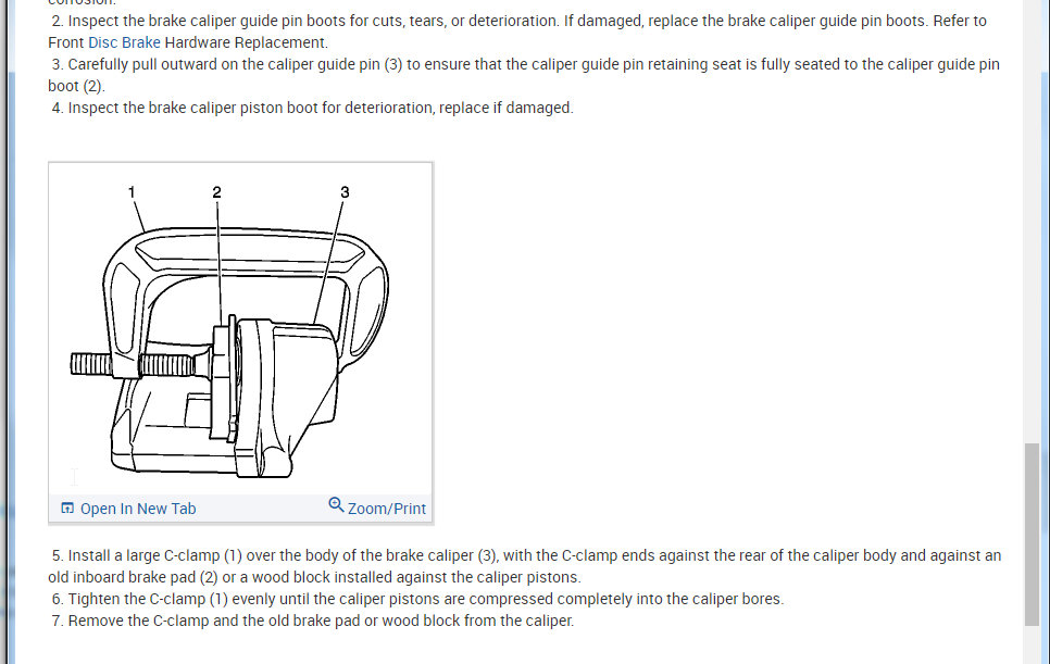

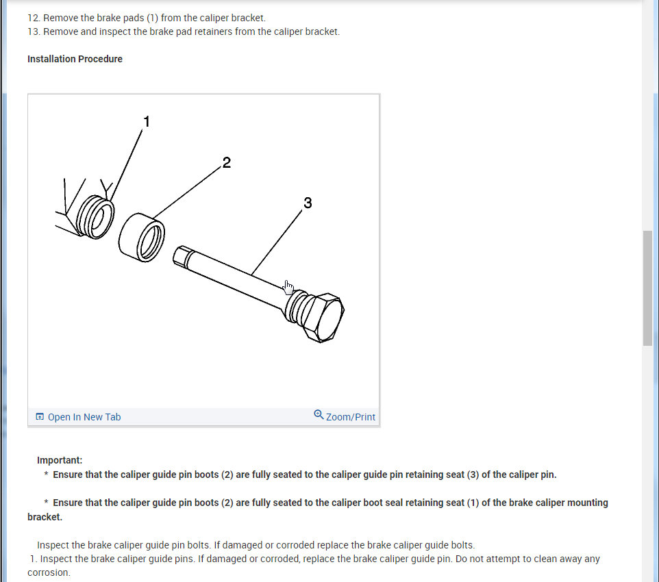

Here are guides that will help with this:
https://www.youtube.com/watch?v=1dB17cMwSOQ
https://www.youtube.com/watch?v=tSHZPQewfd0
Below is the info from the manual that will help get this finished as well.
Please run through this material and let us know if you have other questions. Thanks
