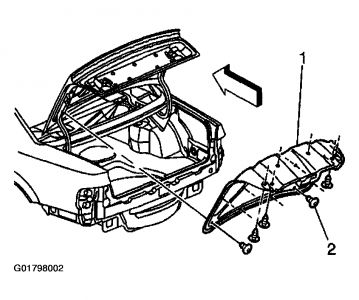

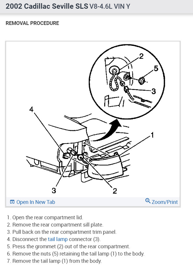

How do I change the brake light on the trunk next to the license plate on the driver's side. It looks like it is one piece. I see there are bolts to remove but I cannot remove the lenses from the trunk lid to get at the bulb. Do you have directions to instruct me how this is done or does it require the use of special equipment to free the lens housing from the trunk lid to access the bulb?
May 30, 2010 at 3:49 PM
BLUELIGHTNIN6
  • 16,542 POSTS
open the trunk lid then remove the side trim of whichever side you are on. disconnect the electrical connectors and press the grommet out of the compartment area. remove the fasteners securing the tail lamp assembly then slide assembly out so you can replace bulb(s). Check out the diagrams (Below). Please let us know if you need anything else to get the problem fixed.

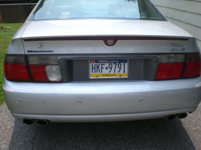

Thank you for your reply but yes these are brake lights. They are red and they only go on when you put your foot on the brake. I would consider that a brake light. There are about 12 bolts that hold the panel that goes across the back of the car on the truck lid. The panel is loosened from the car but I can not pull it away far enough to access where the bulb is. It seems that there is something else holding it in place. Any idea what?? See pic attached - The car was purchased used and apparently there had been a slight fender bender which resulted in cracking one of the red lenses.

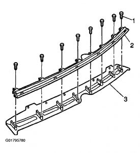

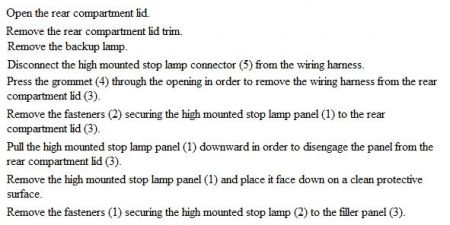

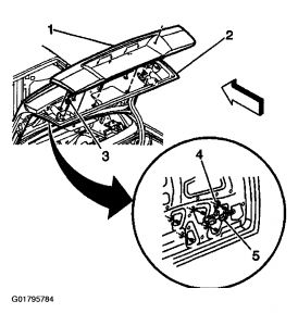

sorry about that, thanks for clarifying with a picture though. that is considered your high mount stop lamp and is replaced as an assembly. that entire strip, including the painted area, comes off together.

yes, the lights are the long strip in the 2nd diagram above..it looks exactly as your picture does to me..?
the first diagram i posted will be used after you remove the entire strip with painted surface. . it is showing the red strip area being removed from the painted strip .

Ok, I can see that this is how you remove the top red strip light. I am not trying to remove that light/lense. I am trying to remove the lower strip that includes the white back up light strip. The bulb that I want to replace should be in the 2 square red lenses to the side of the license plate. The one on the driver's side - the red lense is also broken - therefore it looks clear in the pic I attached before.
Are you telling me I have to remove the top part first to remove the bottom? If so, I still don't see any way to remove the top part from the outside. Is it possible to replace a bulb in the bottom strip as I described? I have not been able to locate that whole piece from a junk yard yet.

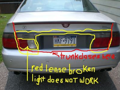

I have highlited in red how the trunk closes - it meets the bumper under the license plate. I have highlited, in yellow, the set of ligts/lenses that are connected to where I am trying to replace the bulb and have pointed to the specific area where the light is out with a yellow arrow. The area that houses the license plate also seems to be part of this set of lights/lenses.

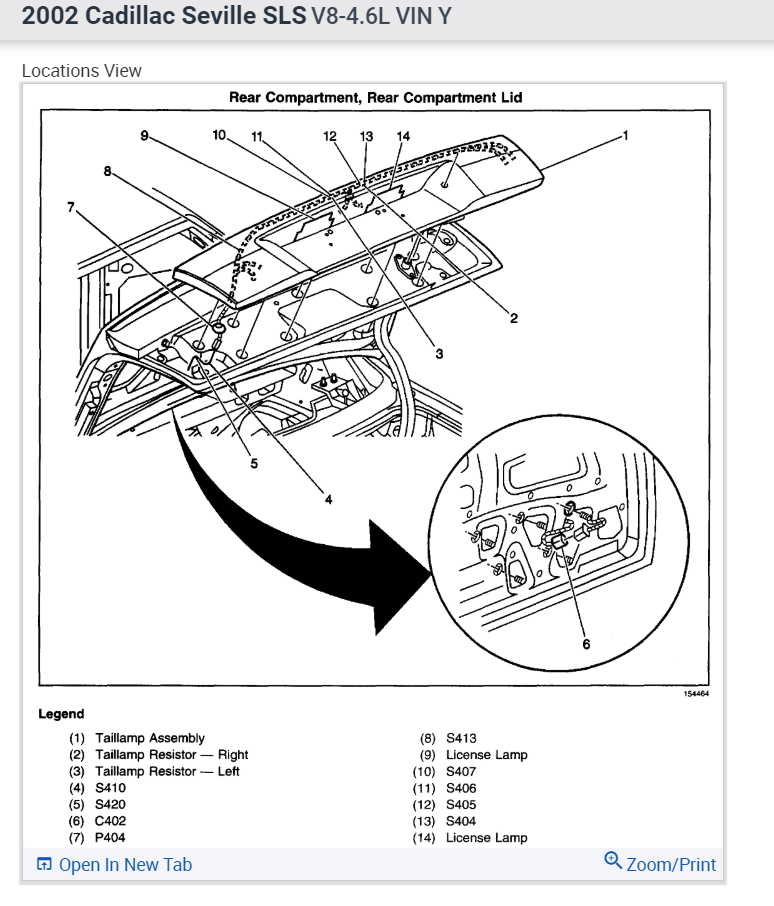

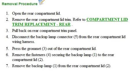

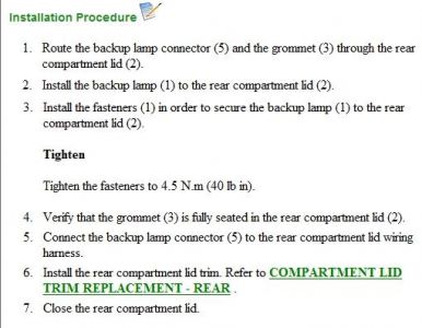

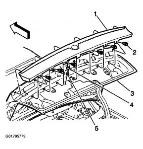

aha, that really clarifies things. thanks so much for that. that area is called the back-up lamp assembly, so now let's see if these steps will help to remove it.
https://images.2carpros.com/forum/automotive_pictures/261618_Noname_2294.jpg

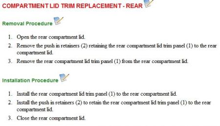

There are no brake lights in the trunk lid, just park and backup lights. Unless you are talking about the high mounted brake lamp, it is a LED style light, and only serviceable by replacement. To remove the lower light board(including the license plate), remove the deck lid trim panel by removing the push-in retainers. It is held in with 10mm nuts, there is like 5-7 of them approximately.
