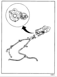

How do i replace the starter on my 2001 Cadillac SLS?
I know its inside the manifold, but i don't know how to get to it.

Notes STARTER MOTOR REPLACEMENT REMOVAL PROCEDURE
https://images.2carpros.com/forum/automotive_pictures/12900_s1_25.jpg

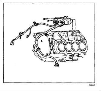

Disconnect the battery negative cable. Remove the intake manifold. Disconnect the BAT cable from the starter. Disconnect the wire from the "S" terminal on the starter.
https://images.2carpros.com/forum/automotive_pictures/12900_s2_24.jpg
Remove the two starter motor mounting bolts. Remove the starter motor. INSTALLATION PROCEDURE NOTE: Refer to Fastener Notice in Service Precautions.
