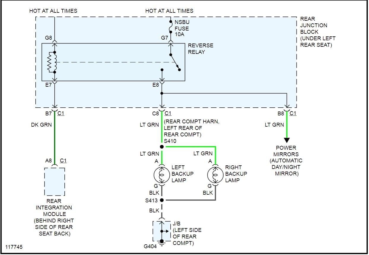

99 seville- reverse lights don't work. bulbs and fuses are good. possible switch on floor shifter problem?

Hi there,
I would be checking the reverse light switch.
Heres a guide on testing wiring, it will help
Attached below you will find the wiring diagram for your back up lights
Image (Click to enlarge)
