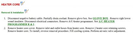

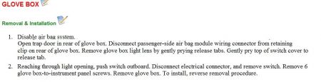

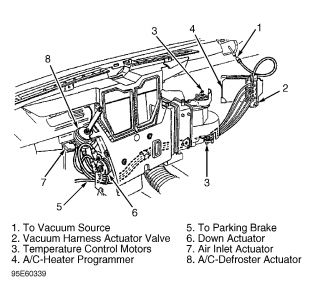

Need pictures or diagrams of heater coil removal.
Difficult access and visibility.
