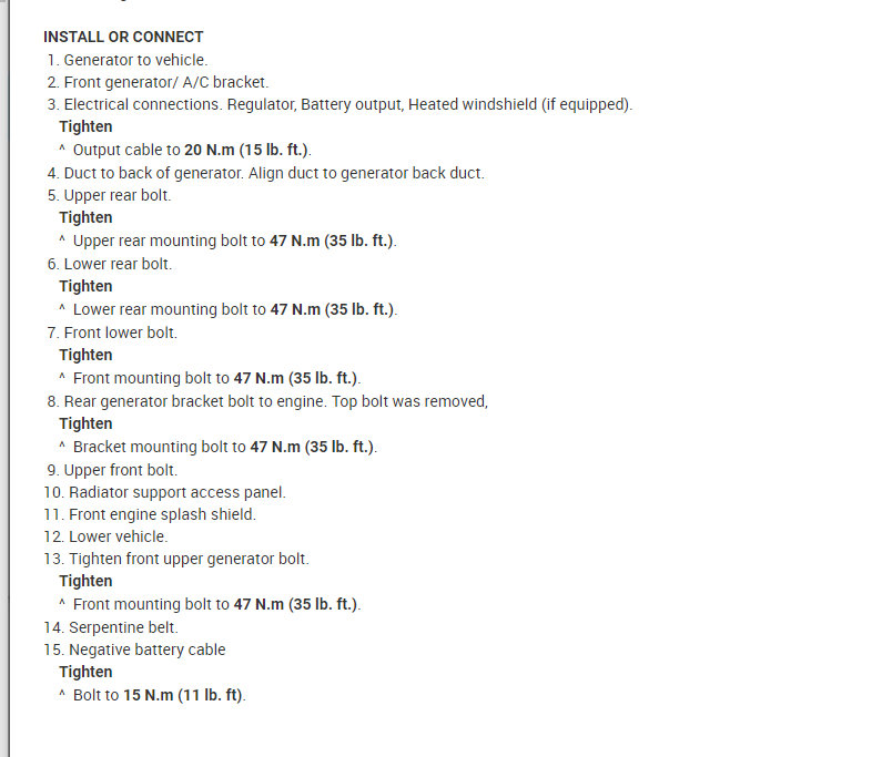

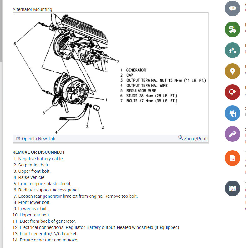

How do I remove and replace the alternator on a 1997 Cadillac SLS?
Jun 29, 2009 at 10:32 PM
  • CAR REPAIR CONTRIBUTOR
Here are a couple guides that will not only help with replacing but testing the alternator:
https://www.2carpros.com/articles/how-to-replace-an-alternator
Also, below is the info from the manual that will give the detail needed on this vehicle to replace this.
However, this is not that detailed so here is a video that may give some good info. Clearly this is on a truck but it is also a GM V8 so it is going to be close.
