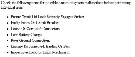

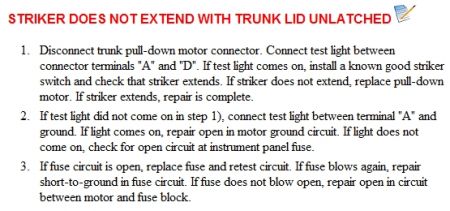

my trunk latch opens with remote but will not close. what can i do besides going to a shop?
