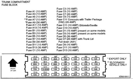

Hi I just bought this 94 SLS and it dosnt have the rear fuse box cover. wich also has the diagram of what size fuse goes where. i was hoping ya'll had one maybe? that was for the "REAR" fuse box...thanks hope yall got sumthin... =D

Don't have a part for it, here is the fuse block details.
https://images.2carpros.com/forum/automotive_pictures/309872_87575949_1.jpg

thank you!!!!!!!!!that is exactly what i needed
