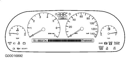

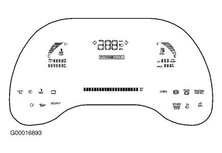

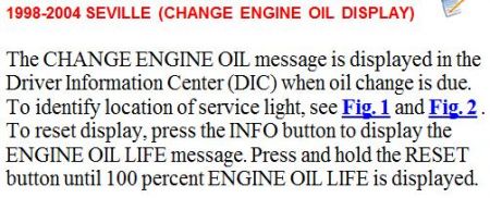

Hello, I am have just purchased the caddy, changed the oil and now need to know how to reset the dash light too 100%. And also it has a rough idle just wondering what your thoughts are on that. thank you. Great site, just stumbled accross i am always tinkering.

https://images.2carpros.com/forum/automotive_pictures/55316_98sevillereset_1.jpg
Fig 1
https://images.2carpros.com/forum/automotive_pictures/55316_98sevillefig1_1.jpg
Fig 2
https://images.2carpros.com/forum/automotive_pictures/55316_98sevillefig2_1.jpg
