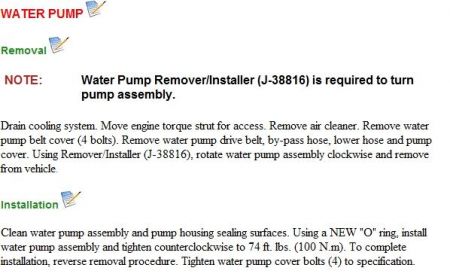

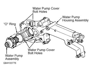

Can you tell me how the water pump comes out
