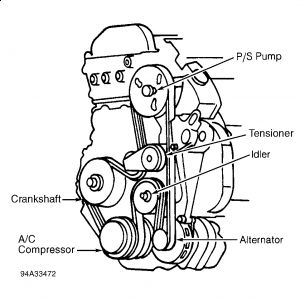

How do you put the serpentine belt back on.

Rotate belt tensioner to allow room to put belt on then release see diagram
