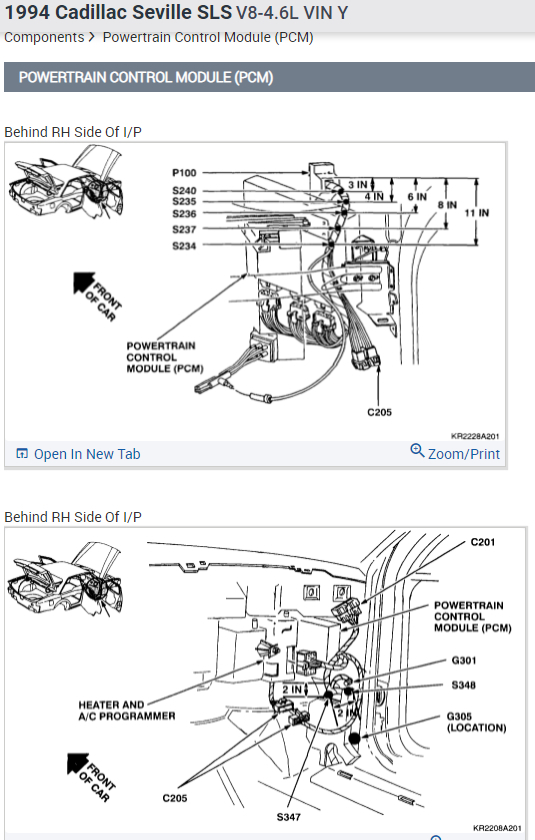

Car not starting need to find out where the computer is located on car?

Please see attached for the location.
What issues are you having with this vehicle?
Have you checked for DTC?
This might be a helpful video:
