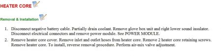

How do I open the heater core box? I've removed the glove box and the lower panel under the glove box. I see it looking at me but I don't see any way to open or remove it.

Hello and thanks for donating Below are the proper replacement steps for your vehicle's heater core. Let me know if you need further assistance with this repair..

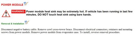

Thanks for your reply.
What does the cowl cross-tower brace look like?
Is it the 2" pipe running across in front of the heater box or the little rod on top that looks like an actuator rod or is it something else?
I hope it isn't the big pipe. I can't even feel the end of it in the middle of the car.l

I will be the little rod that is threaded in

It's out!
It was simple to remove with your help.
THANKS!
