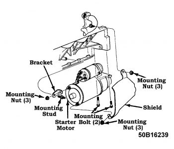

how do i take the starter off of a 93 cadillac seville

You may need to take to a shop if you are not comfortable with this. So what I would do first is call and see if your local parts store can do a system test on the vehicle and let them know you need to test the start most of all. Otherwise here is a pic of the starter and where it is.
