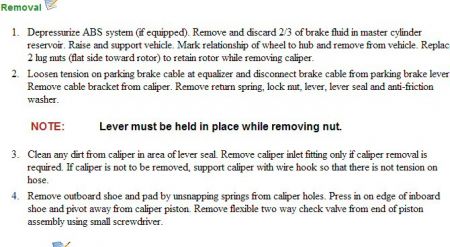

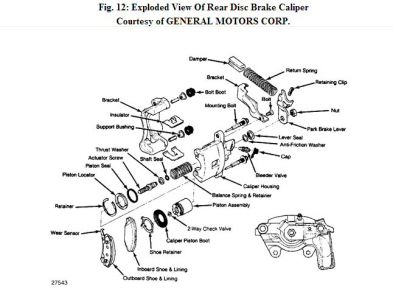

i am installing new rear brakes in rear tires of cadilliac seville 1991. i am unable to remove caliper from rear tires. i have unscrewed 2 screws on mounting bracket of caliper and unscrewed one more . but i cannot get the caliper out please help
