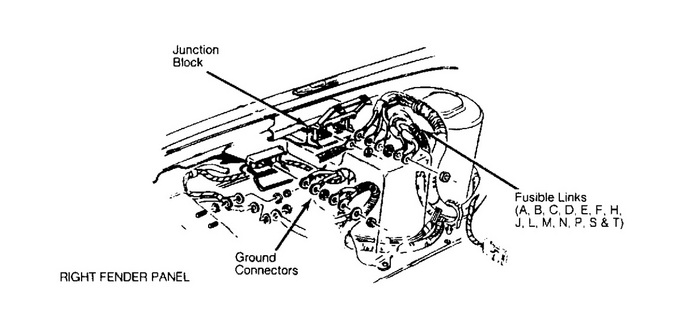

RBURKHART
car has no power. lights won't come on. but the battery is charged (side post). and the ground cable is still conected. corrosion doesn't seem to be the problem. what do i do?
Dec 20, 2016 at 2:40 AM (Merged)
  • 75,992 POSTS
Check and test the fusible link/s
JDL
  • 16,098 POSTS
Take the cables loose, use wire brush or something on the contact surfaces, make them shiny, both ends, even then it could still be a bad cable.
Check for voltage at the junction block, use a voltage tester.
