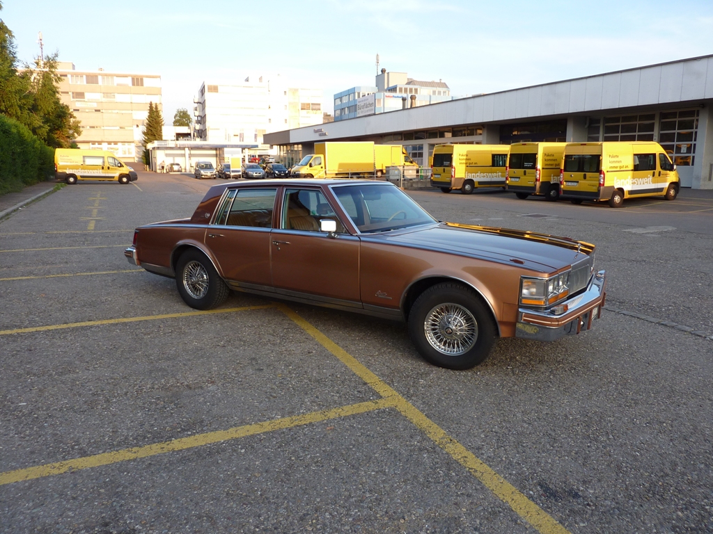

Hello
I have the same problem. where can I buy such a temperature sensor? I live in Switzerland and I do not find us.
Thank you for your help

Thank you for your reply. Do you know a dealer who sends abroad?
I have already tried but without success. You know the part number for this sensor? Is this one like in the picture? Many thanks for your help.
if this does not work, I have to scrap the Seville since I no longer bring the car through inspection.
