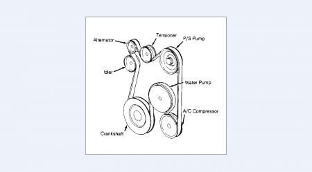

I have a 94' cadillac concors on which the serp. belt popped. there is no diagram under the hood. how do i route this, does anyone have a diagram?

hope that help
https://images.2carpros.com/forum/automotive_pictures/99387_cadi_1.jpg
