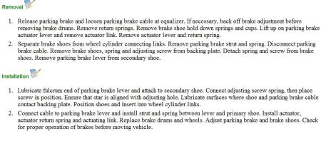

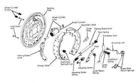

I can't get the rear drums to come off, I have removed the plug from the back of the splash guard and released the tension on the brakes, I have also pushed in the parking brake cable. But the outer portion of the drum will not come off. Any Ideas?
