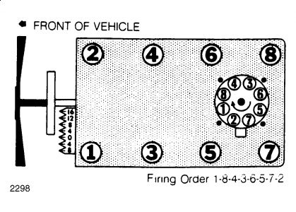

I need the firing order & were is #1 cylinder

https://images.2carpros.com/forum/automotive_pictures/261618_Graphic_313.jpg
