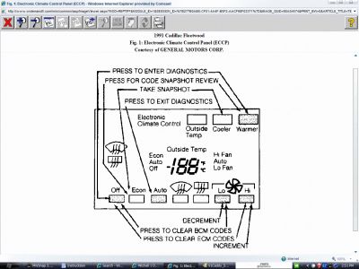

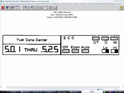

i know there is a way to get the codes off the dash but am not sure which series of buttons to push could you please give men that info

Turn the key on, press OFF and WARMER at the same time, Hold them until all segments of the fuel data center and eccp light up. This indiactes the beginning of the
https://images.2carpros.com/forum/automotive_pictures/62217_Self_Diaga_1.jpg
https://images.2carpros.com/forum/automotive_pictures/62217_Self_Diagb_1.jpg
diagnostic readout.
