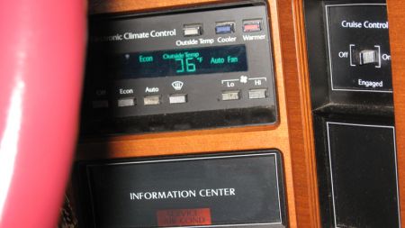

Is there a way for you to take a picture of your heater and AC controls. I need to see what it looks like
Apr 26, 2008 at 2:24 PM
JRNEAVES
  • 10 POSTS
here is a picture of the Cadillac temp control panel. You can see the Service Airconditioning" light lit.
https://images.2carpros.com/forum/automotive_pictures/182288_caddy_1.jpg

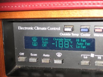

try pushing off and warmer at the same time,with the key in the on position to see if it will go into diagnostics, it works with 89's and up to get codes

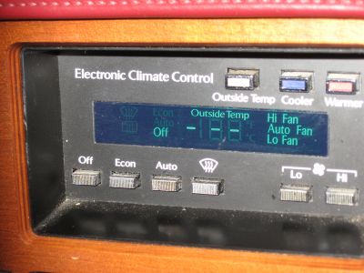

I followed your instructions. Here are pictures of the result. Is this the diagnostic mode?
https://images.2carpros.com/forum/automotive_pictures/182288_caddy_01_3.jpg
https://images.2carpros.com/forum/automotive_pictures/182288_caddy_02_3.jpg

it means the code went away, I need to see if that heater control head will put the car into diagnostics, push off and warmer at the same time, with the key in the on position, look at the message center there and see if you get codes from it, other wise take it to autozone and get the codes read when the light comes back on its free and maybe we can kick this in the butt,,, lol

The temperature outside today is around 40 degrees. The heater controls quit working again. I disconnected the battery but it did not reset. I will try again this afternoon because it is supposed to heat up to 80. Also, when I press the off and warmer buttons with the engine running it lit up the message center with the following, like it was running diagnostics. Messages in order they appeared. .8.8.8, E52, F, F46, F47, F.F, F47, .7.0.
Are these diagnostic codes?

there you go thoes are your codes, yeah!!!!! lol
the E52 is throttle angle prob, you need to clean out your throttle plates and egr tubes, remove the air cleaner engine off, look down the throttle plates and there are 2 tubes in the bottom, make sure there cleaned out use a coat hanger, then start it up and with a can of carb and choke cleaner clean out the black junk in the throttle plates
your f46 and f47 are you AC codes, when codes are present it wont work, F47 I know is low freon level F46 may be high pressure switch, I would get both of them changed (switches) High and low pressure switches as long as the freon is still full
did they change the orfice when they have done your evac and recharge, have them do that also, the low pressure switch you can change, but the high switch has to be evacuated
also if it is still R12 you may want to switch it over to R 134 freon the kit is cheap 30 - 35 bucks
