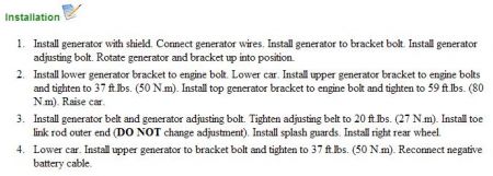

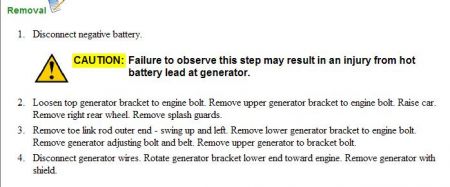

1987 Cadillac Fleetwood V8 Front Wheel Drive Automatic 200k miles
I am wondering if there is anything special I should know when replacing the alternator on this vehicle? (ex. any hidden bolts, removal of other parts, etc..)

https://images.2carpros.com/forum/automotive_pictures/261618_Noname_1426.jpg
https://images.2carpros.com/forum/automotive_pictures/261618_Noname2_422.jpg
