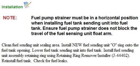

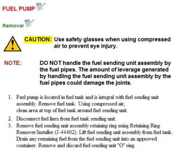

How do I change the fuel pump on this vehicle

https://images.2carpros.com/forum/automotive_pictures/261618_Noname_2194.jpg
https://images.2carpros.com/forum/automotive_pictures/261618_Noname2_712.jpg

It is inside the fuel tank, there fore the tank will have to be lowered. This is best achieved when there is a low fuel level to minimize weight and instability. There is probably a tank shield, then pressure,return, and evap lines, along with filler and vent tubes. Disconnect the pump/sender connector and tank pressure sensor and lower the rear(axle) end of the tank first, to allow it to move back to facilitate lowering the front.
