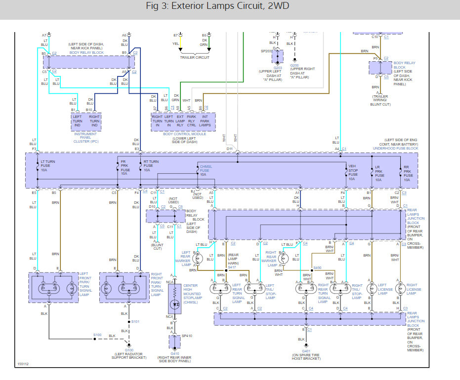

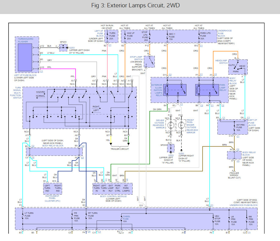

hi, i have a 02 escalade ext and the lights for the gauges don't work, I've already checked the fuses, and the message center screen doesn't work at all either, also the lights and the numbers on the stereo and the letters or numbers on the trip computer (the one that says driver 1, fuel economy. . . ) doesn't work most of the time and never at night but they do work after I run the truck for a little bit on the day. . . . . . . . what i want to know is if i can fix this by replacing the whole gauges and can i fix the other problem with the trip computer and the radio, what should i check and how i really cant afford to take it to a dealer or a decent shop. . . thanks

I hope I can be of little help to you. I have looked at the intricate diagrams for the circuits you have mentioned (driver info center, instrument cluster, and radio). There is one relay that keeps popping up in all circuits. It is called "Body Relay Block" under left side dash near kick panel.

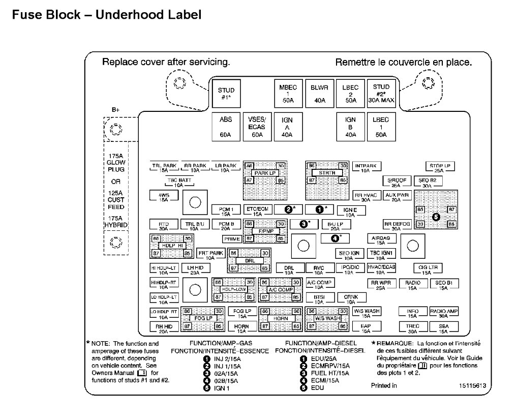

  • 55,540 POSTS
I have seen the park lamp relay go out causing this issue, here is the location of the relay so you can change it out and I have included the exterior lighting wiring diagrams so you can see how the system works. Also make sure to check the fuses. Check out the images (below). Please let us know if you need anything else to get the problem fixed.
