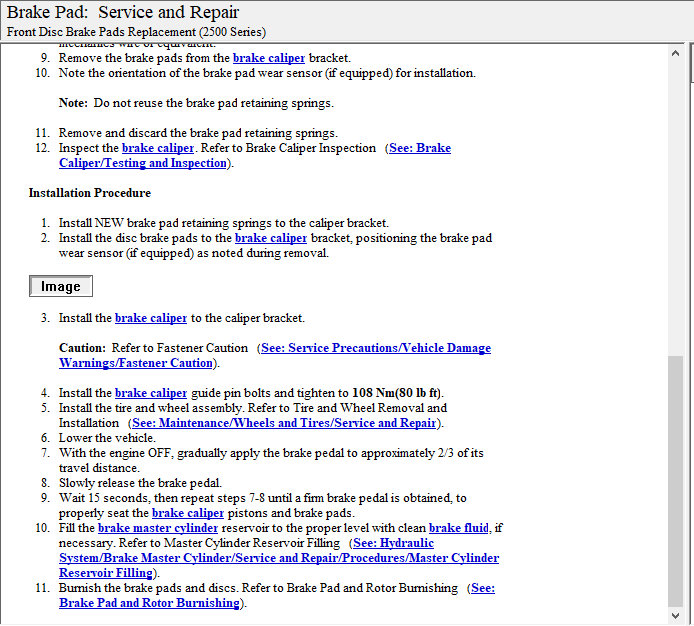

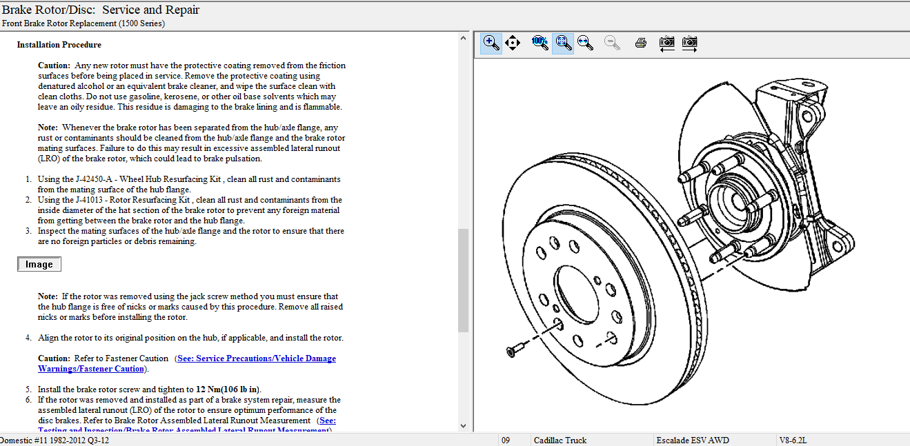

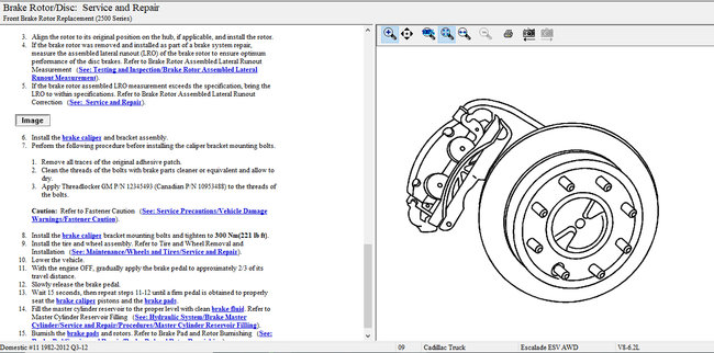

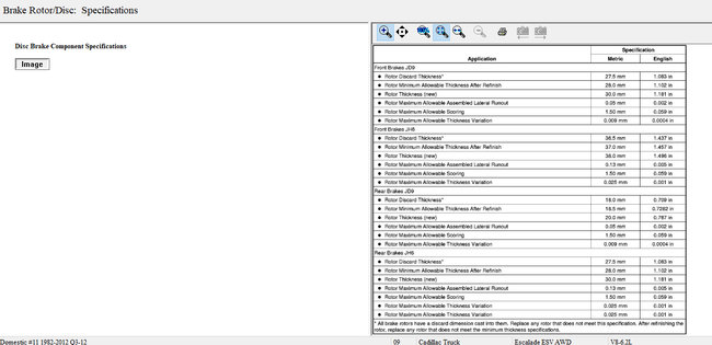

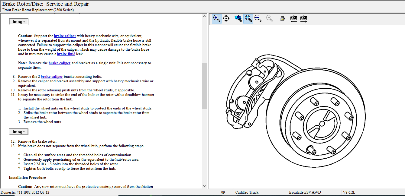

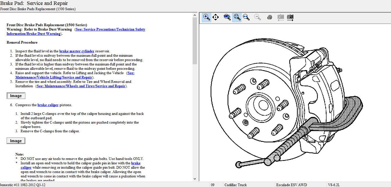

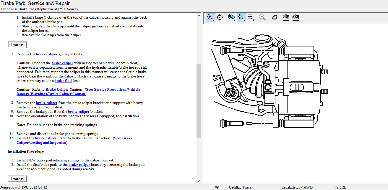

Im having problems with my truck. the brakes are making noise so I think I need to replace them.
May 2, 2010 at 1:24 PM
SEVAG P
  • 405 POSTS

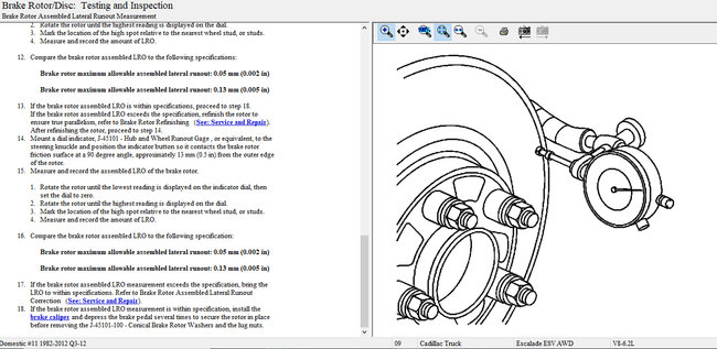

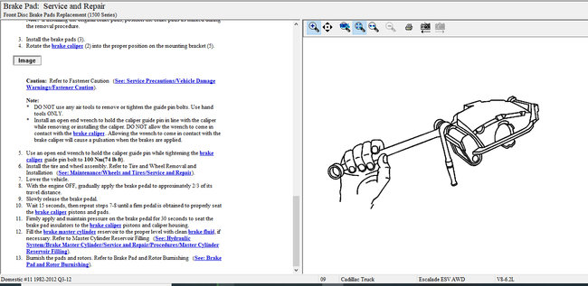

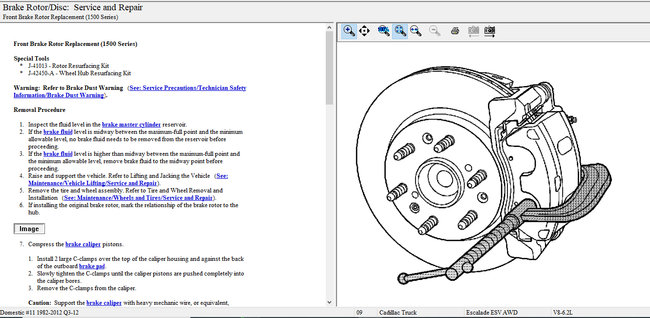

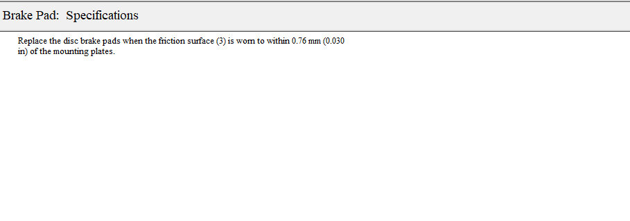

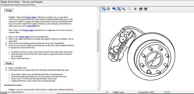

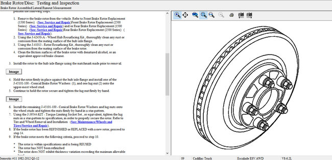

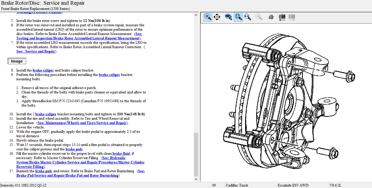

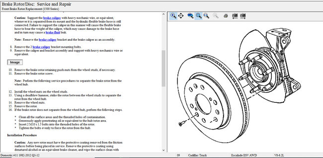

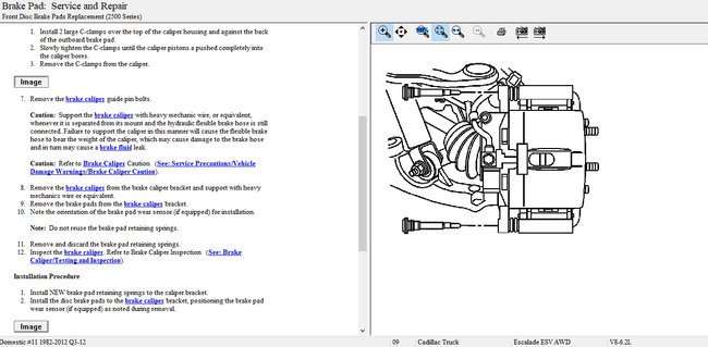

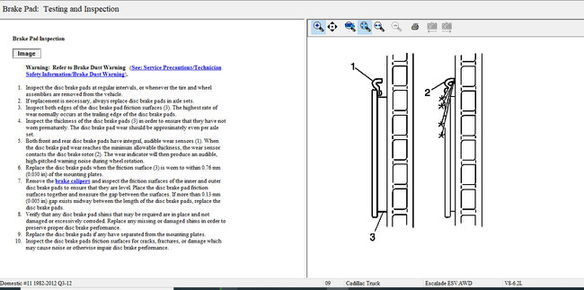

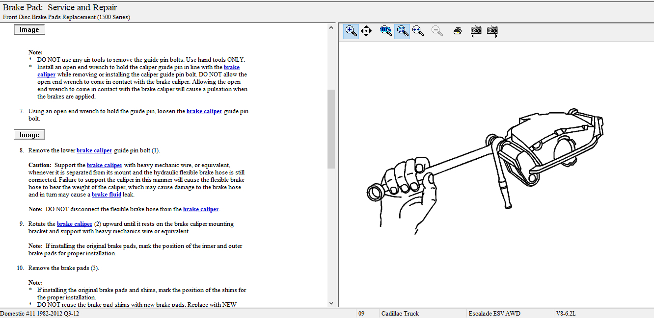

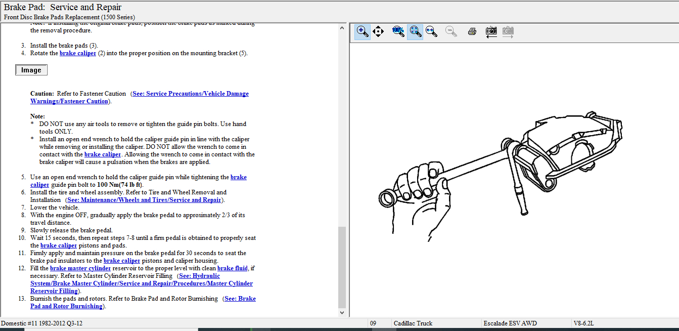

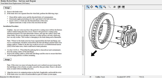

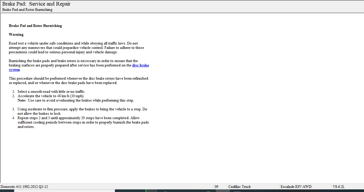

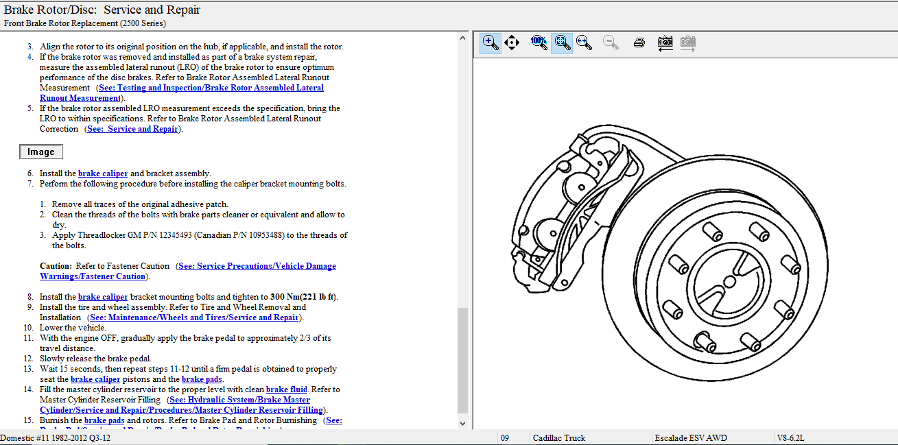

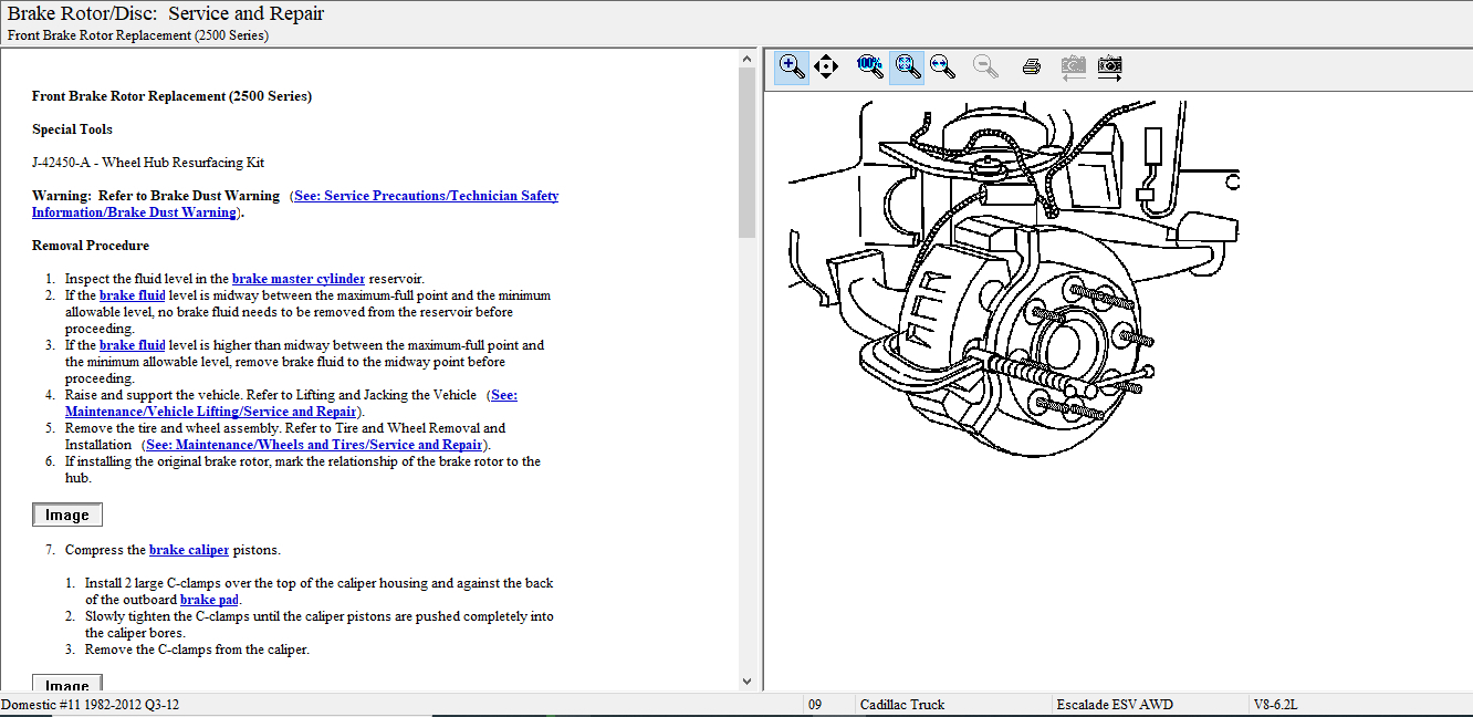

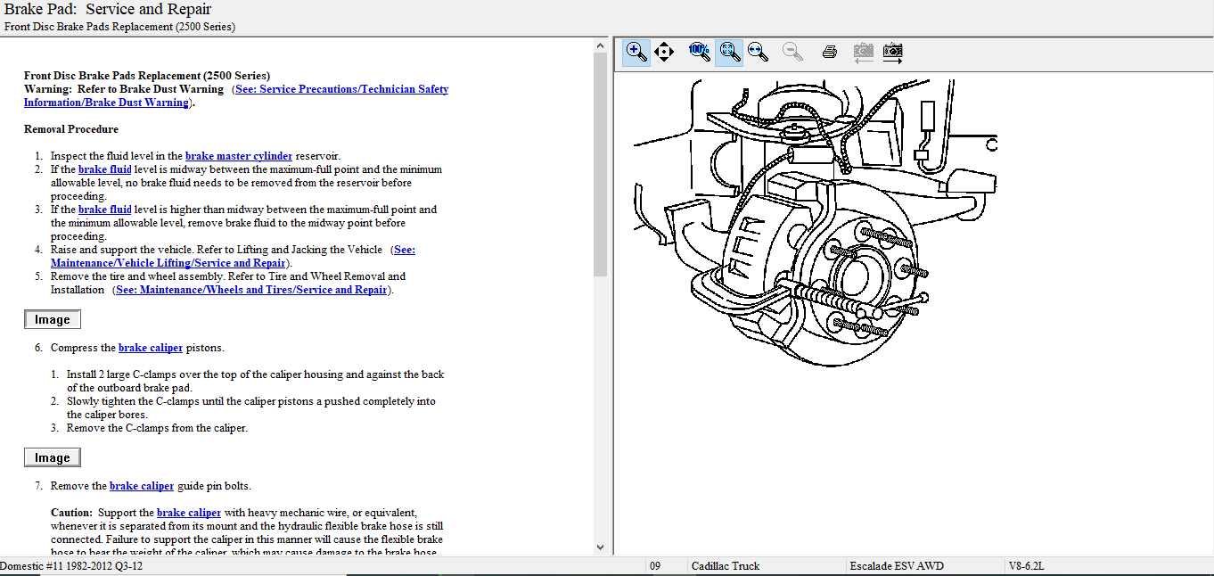

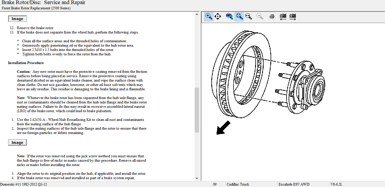

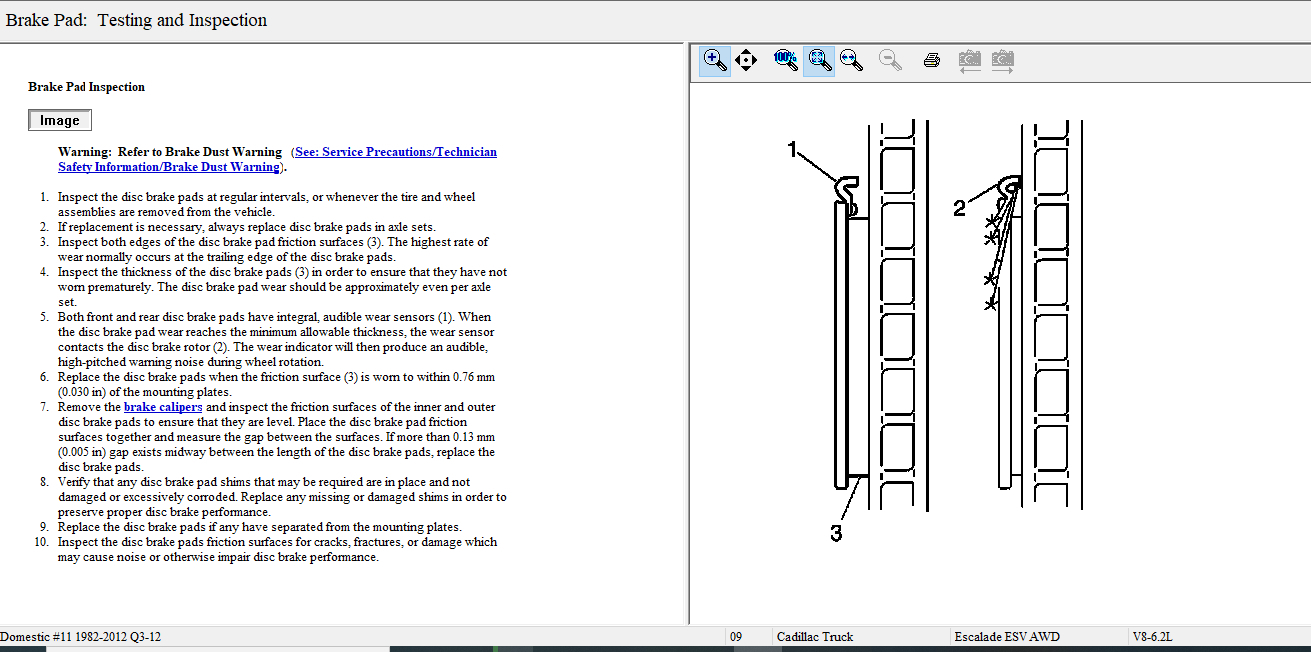

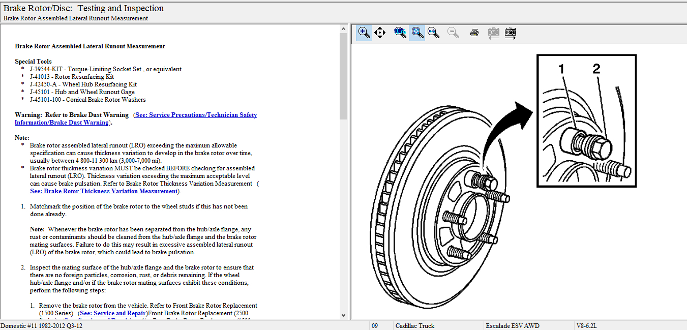

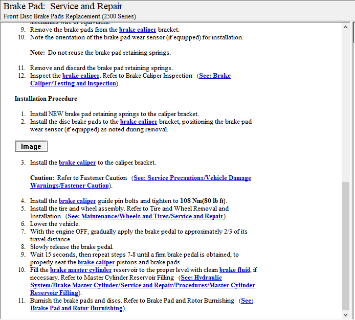

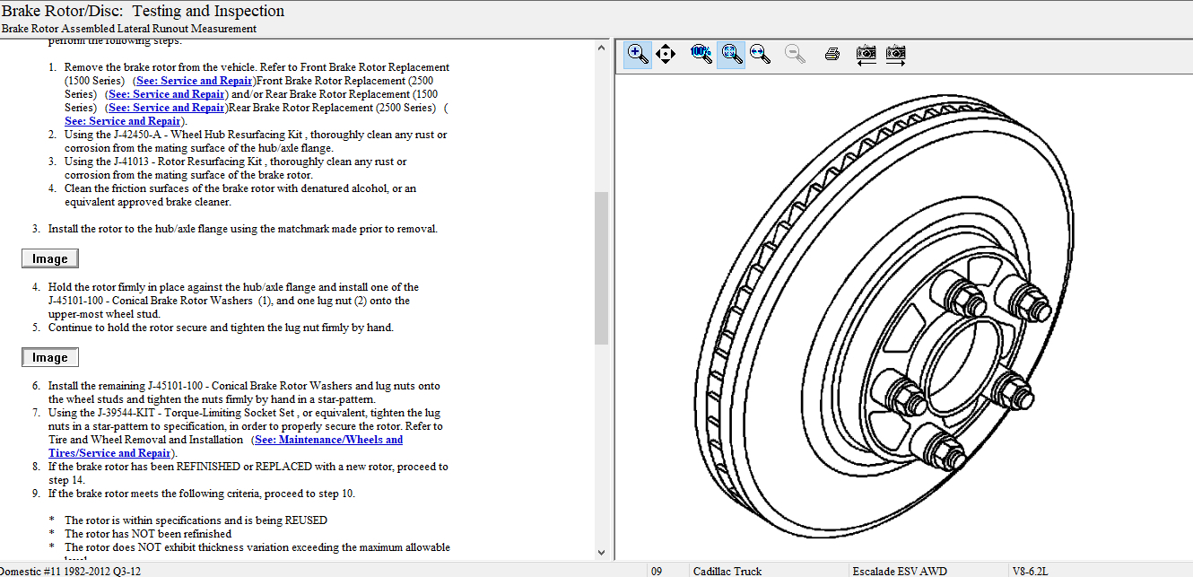

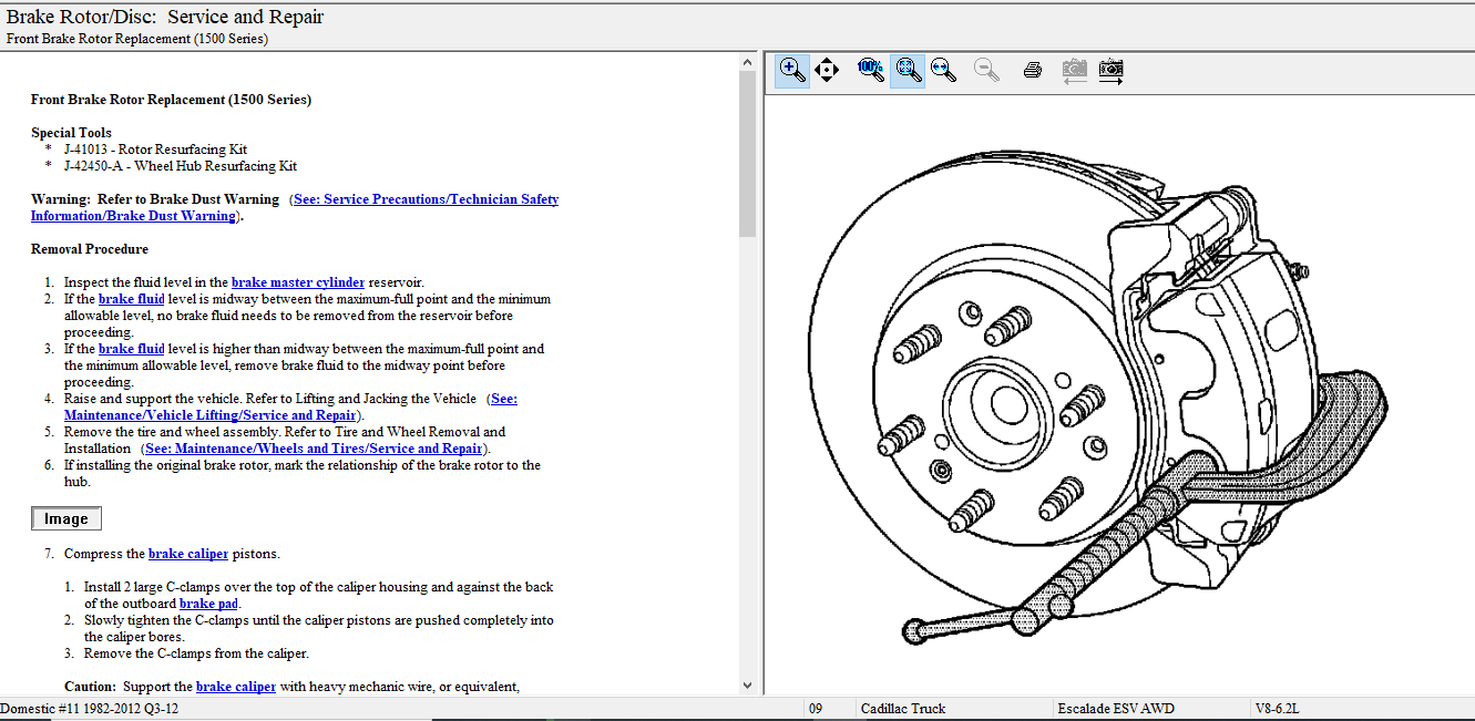

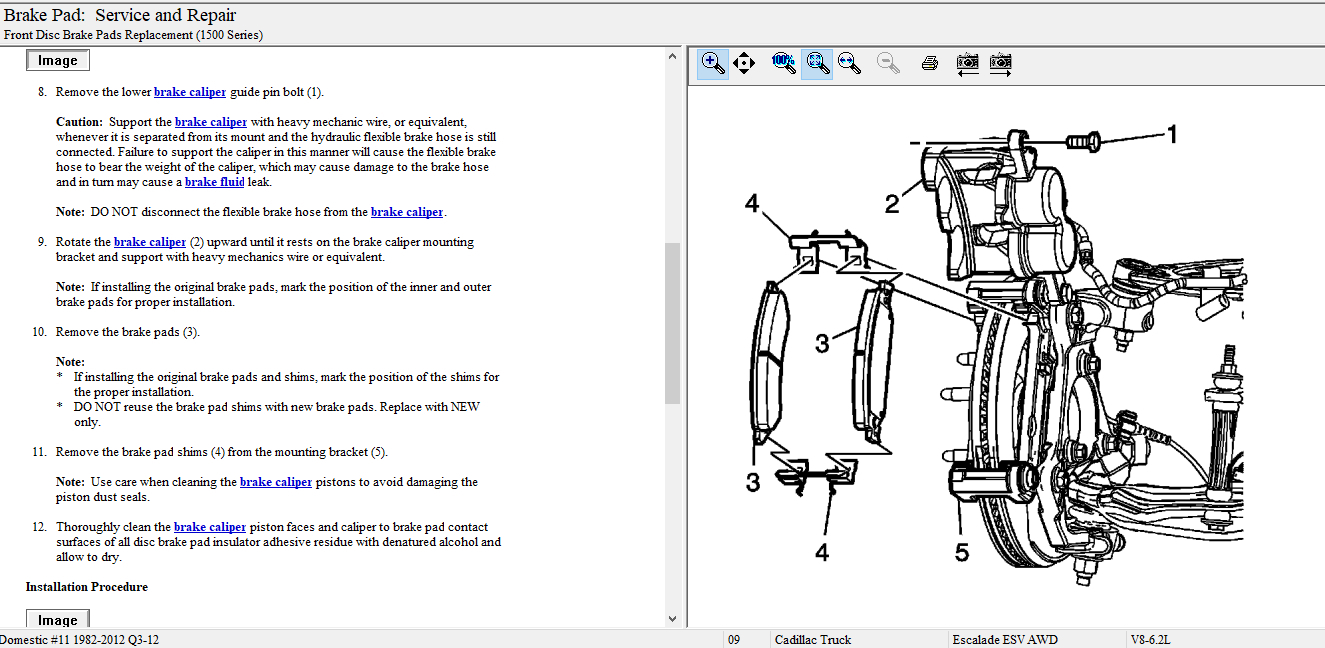

hello,
Yes, follow the instructions below you can do the job easily.
Check our guide below how to replace front pads and rotors.
check our video below its for chevrolet but identical to cadillac brake system
https://youtu.be/9pwFodKAl5A

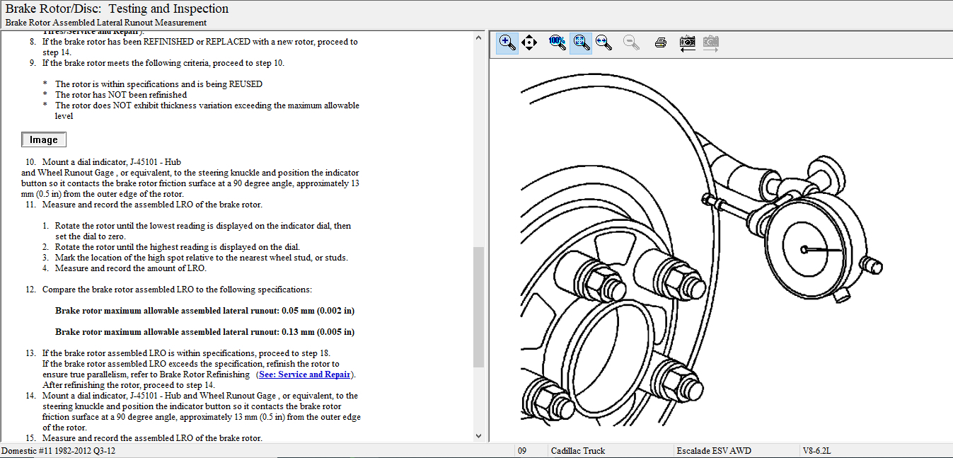

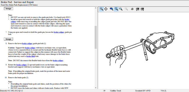

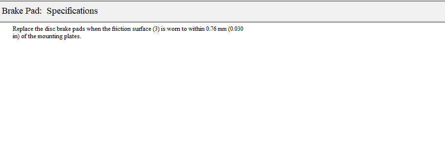

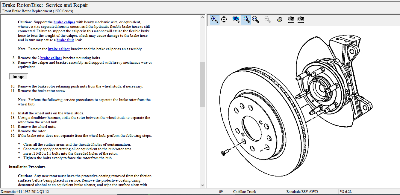

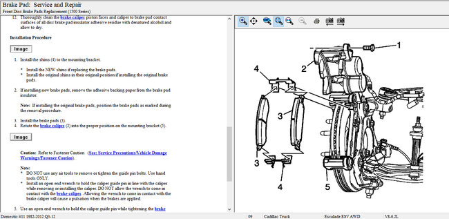

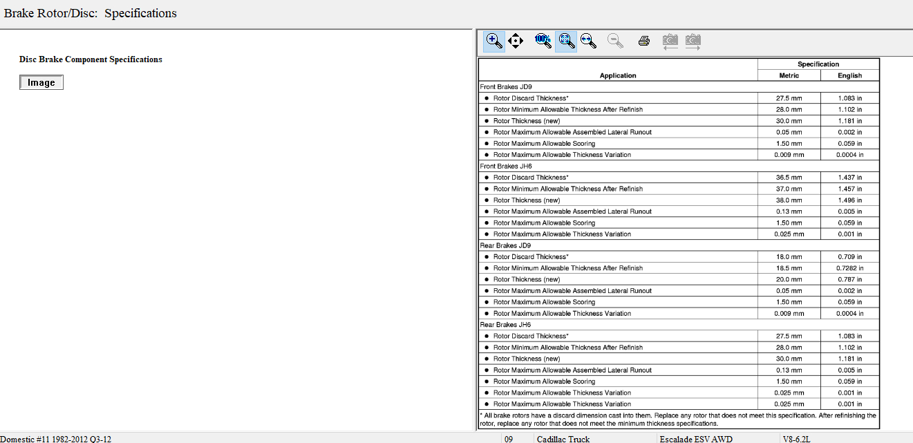

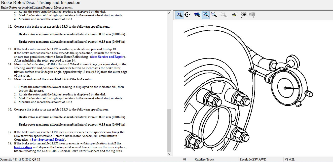

Check the diagrams below for series 1500 and series 2500,brake pads replacement procedure with tests and measurements.
hope these helps .
thank you.
