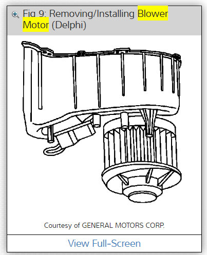

My back blower is working and my front is not, but it will cut on while am driving sometimes and then it cuts back off within a couple of minutes. I have checked all of the fuses that are listed in the manual. Thanks in advance

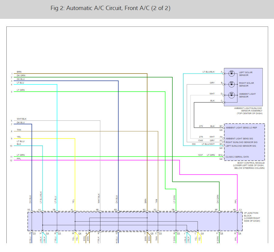

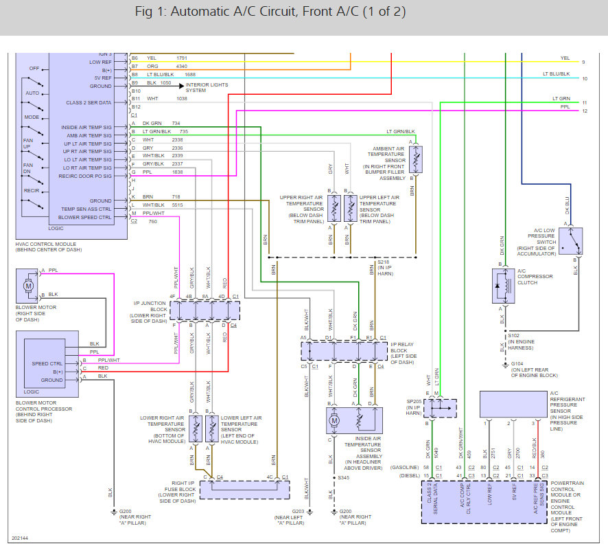

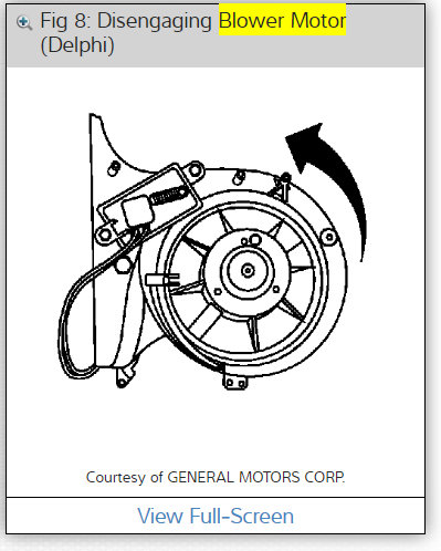

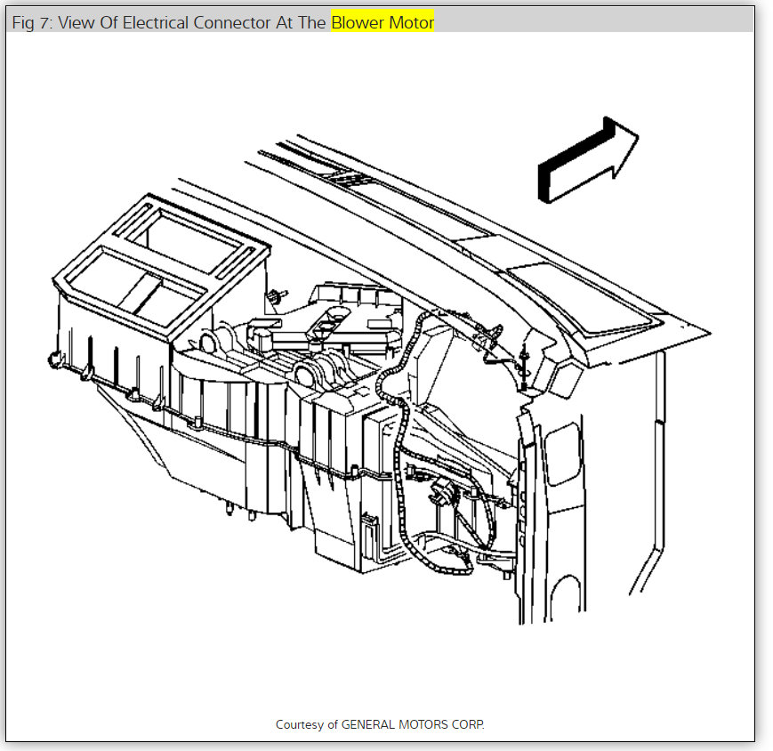

This sounds like a classic blower motor that was gone out. Use a test light to confirm power and ground when the blower motor is not working. Here is a guide and some diagrams below to help you get the problem fixed:
https://www.2carpros.com/articles/blower-fan-motor-works-on-high-speed-only

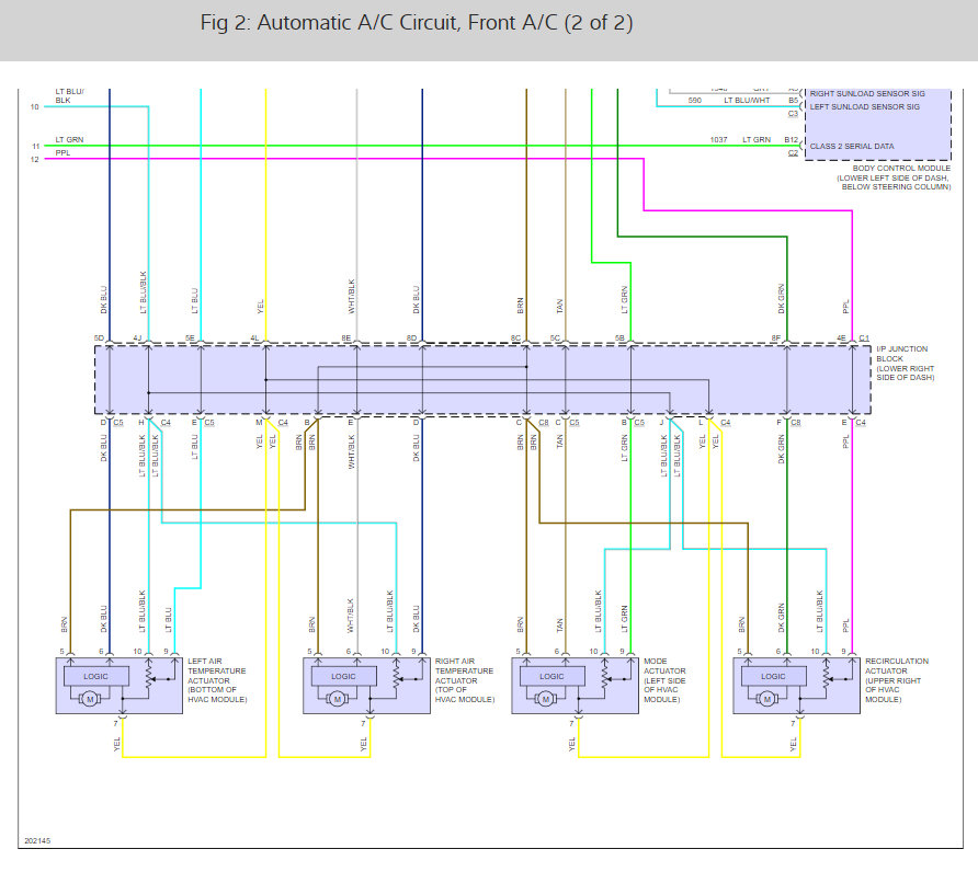

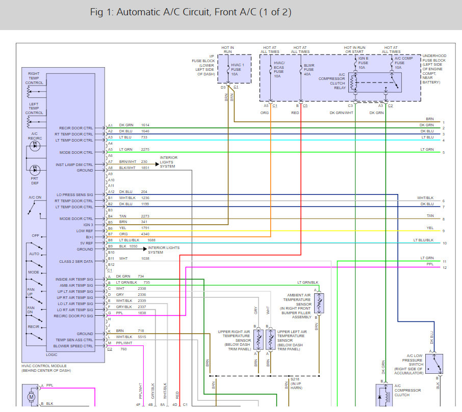

Here are the blower motor wiring diagrams so you can see how the system works.

Thanks! The blower motor fixed my car! I love this site.
