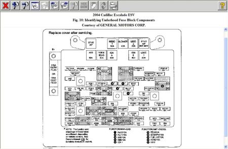

LEFT TRUCK WITHOUT BATTERY FOR 7 MONTHS PARKED INSIDE A GARAGE AFTER RECONNECTING BATTERY DASH , GAS , OIL , TEMP GAGE DONT WORK , DOOR WONT UNLOCK , AND WINDOWS WONT ROOL DOWN OR UP ?

Hi eddlove28, Thank you for the donation. I would suggest checking the following fuses and components. 1. LBEC2 2. IGN A 3. IGN B 4. Ignition switch. 5. Battery terminals and connections.
https://images.2carpros.com/forum/automotive_pictures/192750_FuseBoxEscaladeESV_1.jpg
