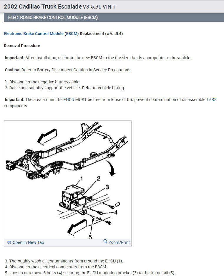

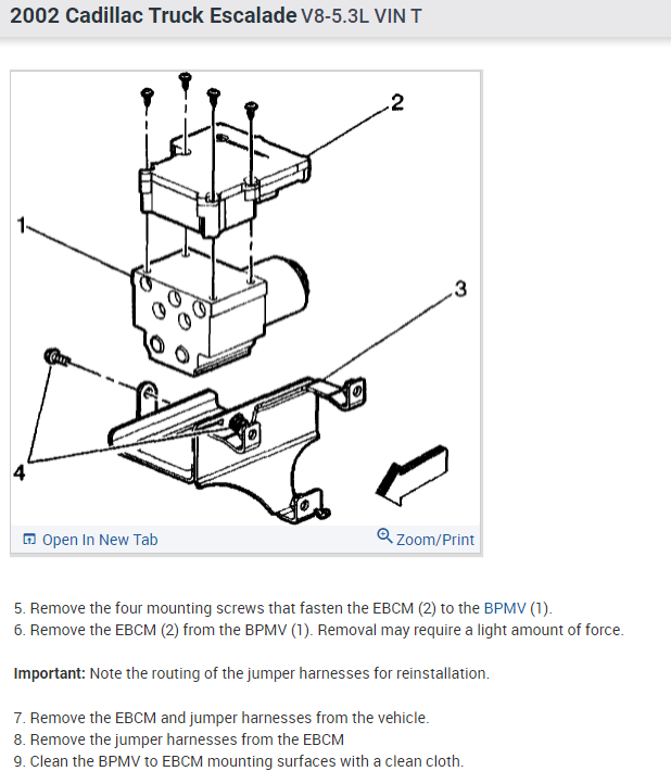

My ABS light is on and the abs brake controller needs to be replaced
Feb 8, 2010 at 9:38 AM
SQM
  • 6,383 POSTS

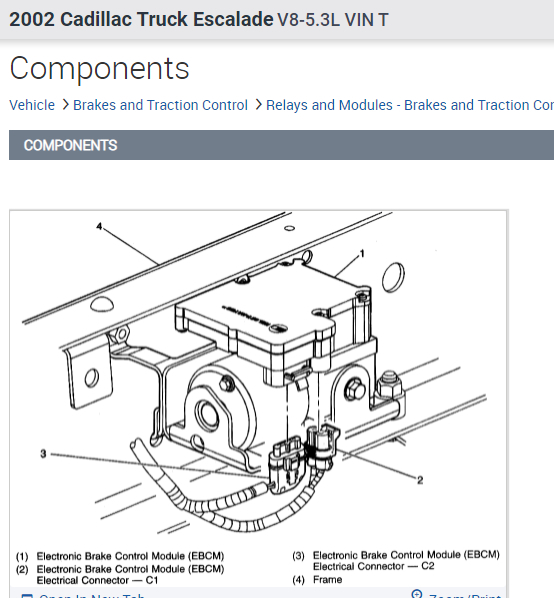

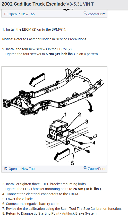

The electronic brake control module is located along the frame rail on the driver side (see diagram).
What ABS codes are you getting? Keep in mind that sometimes the code can be due to faulty wiring and not the module.
Here is a helpful video of retrieving ABS codes:
https://youtu.be/rTtAnsOlZU4
https://www.2carpros.com/articles/how-to-replace-a-abs-controller

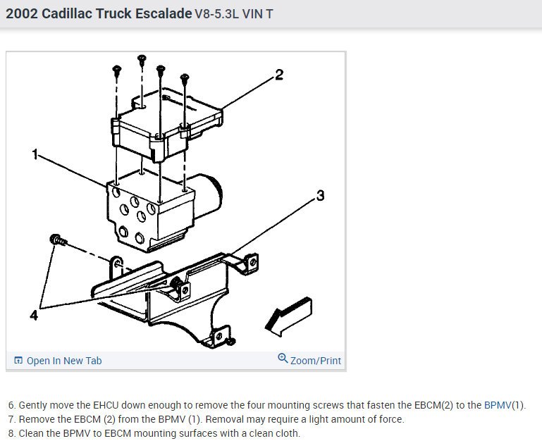

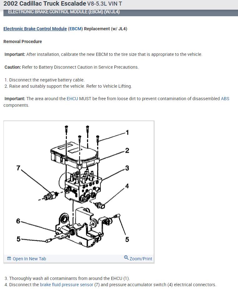

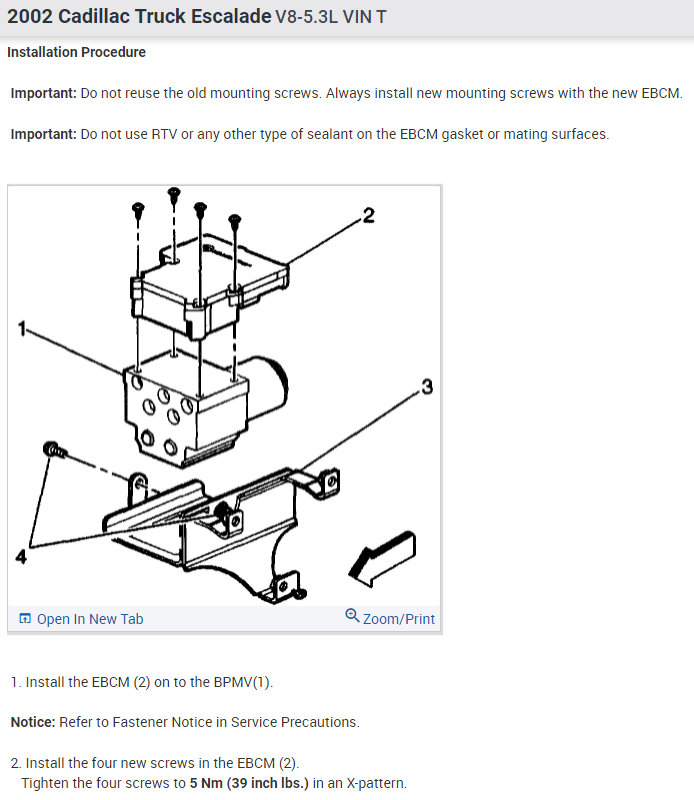

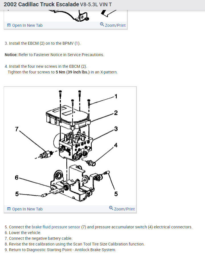

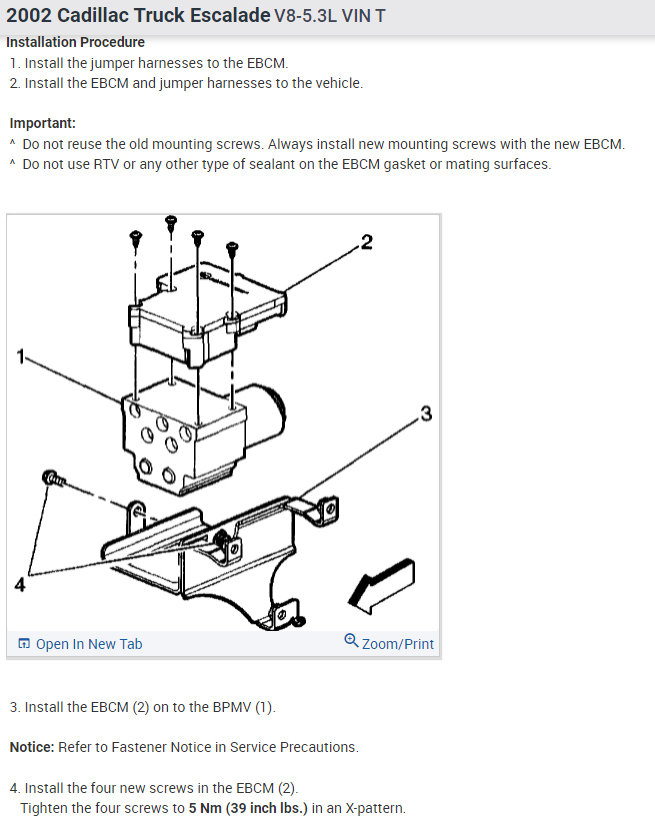

I have attached the replacement procedure for your reference.
