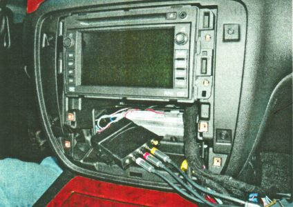

Dear Pros,
I have a question about the front panel.
I have bought a video unlock device, but I have no cadillac service centre in my country. I need to install it myself. TO do it I have to remove the front panel just below the display.
How can I do it?

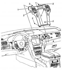

is the picture below the panel you are talking about? if so then it is held in by clips.

Thanx for your comment! Actually what I need to remove you can see on the picture. the problem is that this model is older than mine and I dont know where the clips are and how to remove it. If you have any suggestions, please advise haw can I do it better.

The picture shown is not an Escalade vehicle. If your Escalade has navigation, the panel below the display, and the display are one piece. To remove that panel(the one shown in the illustration from bluelighning), you first need to remove the ashtray/cupholder by pulling up. If you have a plastic trim tool, it can aid in this. Then you need to remove the RH IP vent/trim plate(the one that has brushed stainless and Cadillac logo), and then that center vent panel can be removed. from there you can remove the radio, the climate panel, and the lower switch panel(htd wash, articulated running board, etc...).
