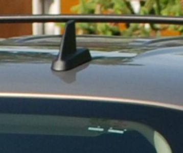

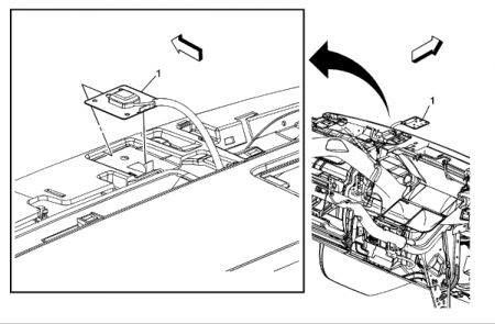

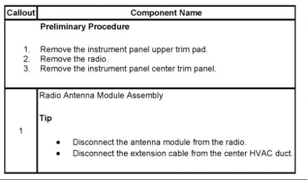

I'm writing to you from Hungary. I own a 2007 Cadillac Escalade and due to some rost nera the navigation antenna I need to make some repair.
Could you inform me how can I remove the navigation antenna from the roof? Maybe a drawing would also be helpful.
Thank you for your help in advance.

Dear Sir, I highly appreciate your quick answer to my question. It is really helpful and I would have only one more question regarding this subject. How do I remove the plastic cover which is on the roof. I do not want to brake anything. Maybe it is just a plastic cap. Can it be removed using a small screwdriver? Thanks once more. Regards

The info you were sent is for the GPS antenna under the instrument panel pad, you are after the onstar/digital radio antenna. That requires lowering the left front of the headlining, and removing the nut that secures the antenna, the plastic cover does not come off. It should just need the LF visor, and perhaps LF door weatherstrip to lower the headlining enough.
