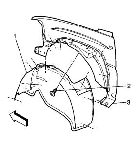

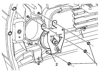

I have a replacement assembly for the drivers side foglight but cant decide the easiest way to get to it to replace it. any help would be most appreciated
Aug 27, 2008 at 4:59 AM
2CARPRO JACK
  • 11,533 POSTS
Looks like you need to remove the inner fender liner
https://images.2carpros.com/forum/automotive_pictures/1639_esc2_1.jpg
then replace the lamp assembly
https://images.2carpros.com/forum/automotive_pictures/1639_esc_1.jpg
