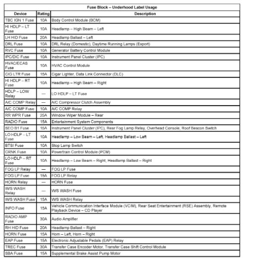

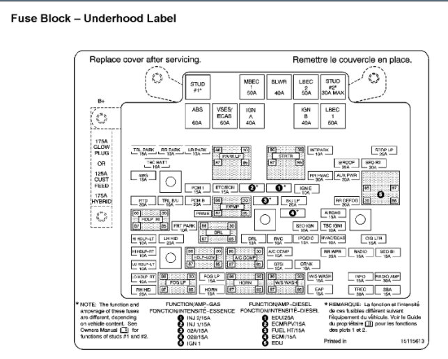

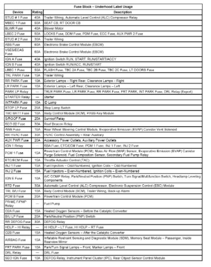

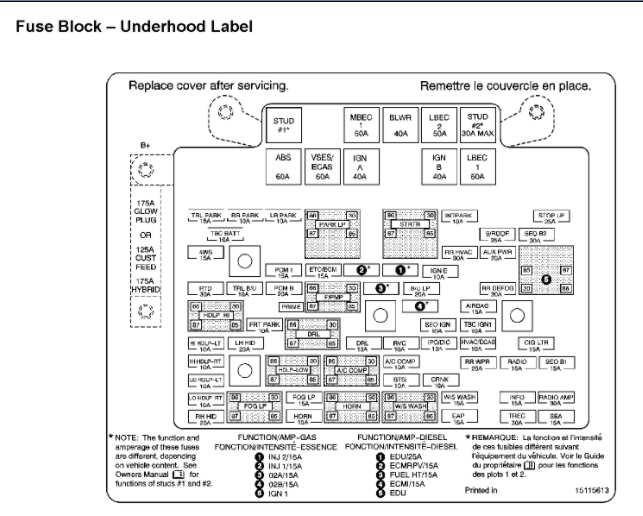

HI! My battery went dead twice so I put new battery in vehicle. Now my blower doesn't work I need to check the fuses where are they and how do it check them?
Jun 28, 2008 at 9:52 AM
DANNY L
  • 5,648 POSTS
Hello, I'm Danny.
Here is the information you requested. Here are a few tutorials for you to view on how to check and replace fuses:
I've attached pictures below showing the fuse and relay locations on your vehicle. Hope this helps and thanks for using 2CarPros.
