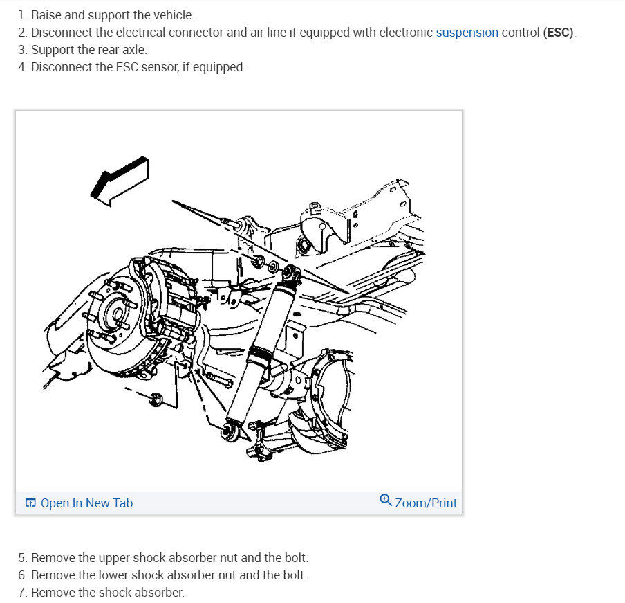

I also found some aftermarket shocks that are at least a little less than Cadillac direct. Would they work okay with the system?
http://www.suncoreindustries.com/cadillac-suspension/escalade/2002-2006-4-wheel-oem-electric-air-shocks-replacement.php
http://www.cadillac-suspension-parts.com/cadillac/cadillac-escalade-suspension-parts.html
Roger
Mar 10, 2017 at 7:12 AM (Merged)
Yes, they look okay. They are not OEM but will bolt up the same as OEM.
