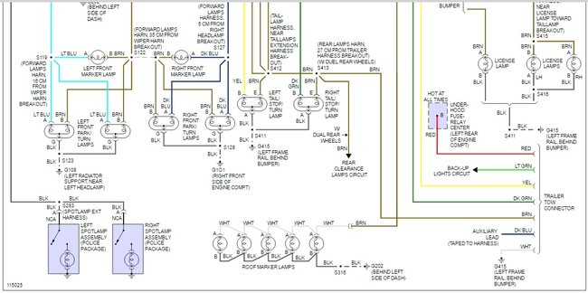

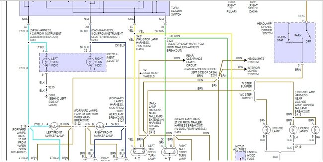

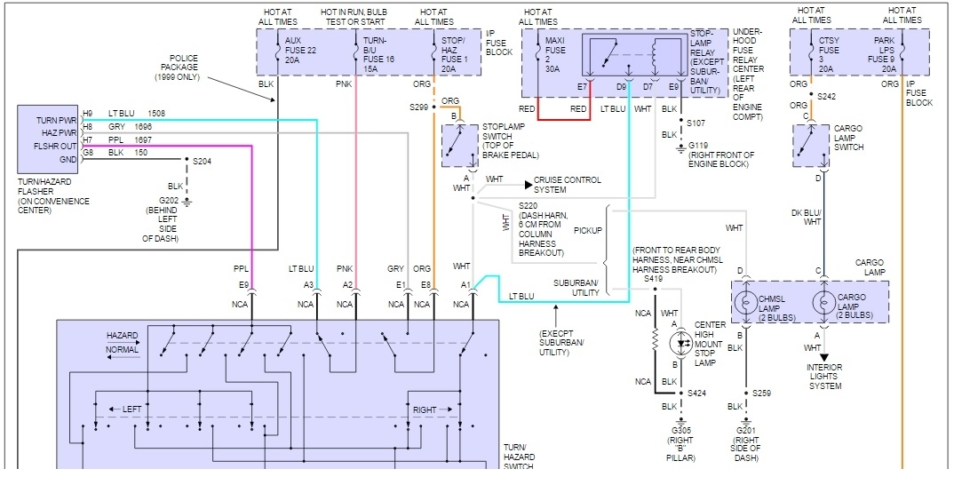

CJ MEDEVAC
  • 11,004 POSTS
These are easy to trace, locations (such as a relays/ fuses, etc.) are listed beside them.
It might be easier to begin with the lights (bottom diagram) work your way through the system sort of backwards, as starting at the top might lead you around like a maze!
If not, continue to respond, other experts from here sometimes jump in to help out as well.
