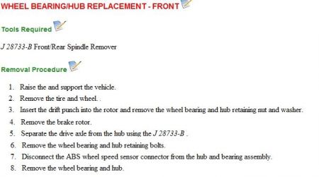

how do I replace my mothers drivers side hub assembly?

https://images.2carpros.com/forum/automotive_pictures/261618_Noname_1931.jpg
