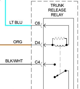

the power trunck release does not work on the dash or on the remote. I have checkled the vault button and it is off. also the doors open and so does the gas tank door from the remote

May be the actuator in the trunk. Open it with the key, now try both the dash button and remove. test for power with a DVOM, if no power check the fuse, if there is power, the acuator needs to be replaced.

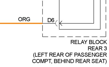

I have tried what you said and get no power to the sol. all other Items hooked to that fuse work is there a relay in there some where that could be the problem????

MERLIN2021
  • 17,250 POSTS
Behind the rear seat.

LARRYDAK
  • 6 POSTS
it is that trunk release motor fond that it sticks ever os often I have lubed it but am sure it will need replace some day soon
