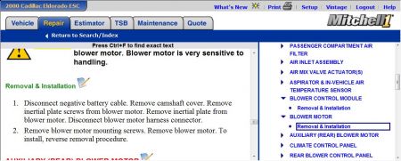

what are the steps in removing the fan blower motor to install a new one? sorry i would love to donate but i am a single mom on ssd i was out a car so i am fortunate for my parents but after the 1st month of having this car the ac blower motor went and i can't afford to take it to a shop and i live in fl and its a hot hot ride please help. god bless

How did you came into conclusion that the blower motor is defective, what type of tests did you performed.

when my father purchased the car he also got a e-iservice manual on line. my dad has a test meter of some sort and he tested the volts to it then he tried to run the motor with a direct wire and a ground and the motor will not come on at all. it does get the proper "juice" to it but it still will not come on. He followed a trouble shoot guide with the e-iservice manual he has. and it states to replace the blower motor it gives direction on how to but the steps are not easy for me to follow. meaning does the one complete coil pack need to be removed? or just the top cover? see I am a 44yr old woman and I have to do this myself and I am below broke, I just want to know all I am in for before I start to do this I don't want to hung up but currently I cant afford to purchase any more manuals etc. Thank you for your kindness in advance. I will donate after I get my bills paid and groceries bought for the month I just have to see where I am first,.....

https://images.2carpros.com/forum/automotive_pictures/12900_blower_motor_removal_1.jpg

The only way is to remove the camshafts cover.It’s not a big deal.1 1/2 hr job

to you both that provided help answers for me!! I believe gstacey understood 100% of what my problem was!
rasmataz your information is right on all the way but I just cant see how to get this fan blower in that tight of an area without hurting something! I pulled one at a junk yard myself but their most of the engine was already missing but I believe gstacey has solved my task. Thank you BOTH for all your help!
