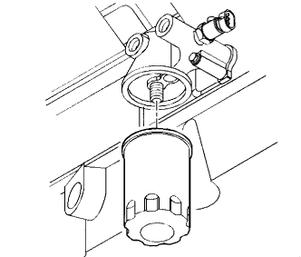

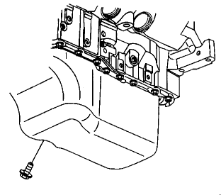

I need to change the oil on my Northstar V-8 but am unsure of where the oil filter is located. Also, are there any special tools required to remove/install the filter?

Might consider buying a cup type oil filter wrench Notes Removal Procedure Raise and support the vehicle. Refer to Vehicle Lifting.
https://images.2carpros.com/forum/automotive_pictures/12900_o1_1.gif
Position the oil drain pan under the engine oil drain plug. Remove the engine oil drain plug. Clean and inspect the engine oil drain plug, repair or replace if necessary.
https://images.2carpros.com/forum/automotive_pictures/12900_o2_1.gif
Remove the oil filter. Installation Procedure Fill the oil filter with oil. Lightly oil the replacement oil filter gasket with clean oil. Notice: Refer to Fastener Notice in Service Precautions.
https://images.2carpros.com/forum/automotive_pictures/12900_o3_1.gif
Install the new oil filter. Tighten the new oil filter to 32 Nm (24 ft. lbs.).
https://images.2carpros.com/forum/automotive_pictures/12900_o4_1.gif
Install the engine oil drain plug. Tighten the engine oil drain plug to 20 Nm (15 ft. lbs.). Remove the oil drain pan from under the vehicle. Lower the vehicle. Fill the engine with new engine oil. Inspect for oil leaks after engine start up. Verify oil level.
