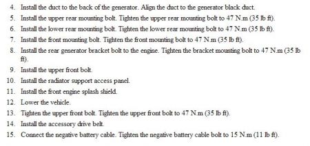

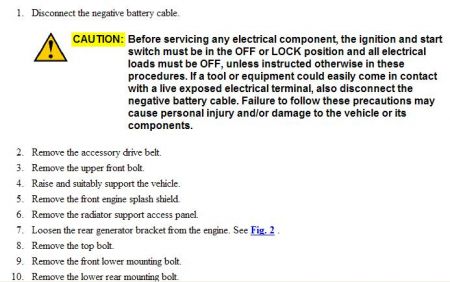

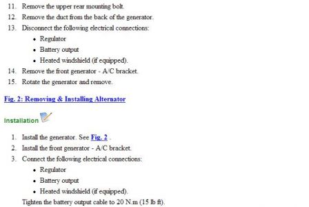

I need to know the best way to replace the alternator on my 98 Eldorado. I have searched and searched and no answers. Seems like a tight fit and not sure how to go about it.

https://www.2carpros.com/forum/automotive_pictures/261618_Noname_702.jpg
https://www.2carpros.com/forum/automotive_pictures/261618_Noname2_182.jpg
https://www.2carpros.com/forum/automotive_pictures/261618_Noname3_65.jpg

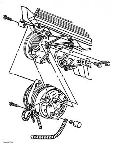

FIGURE 2
https://www.2carpros.com/forum/automotive_pictures/261618_Graphic_84.jpg
