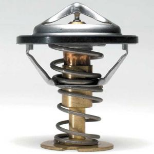

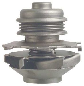

Can you please show me where the thermostat and water pump is And it they look like?
Oct 14, 2010 at 4:57 AM
MMPRINCE4000
  • 8,548 POSTS
https://images.2carpros.com/forum/automotive_pictures/108325_waterpump_1.jpg
https://images.2carpros.com/forum/automotive_pictures/108325_thermostat_1.jpg
Waterpump is a cartridge on left side of motor, driven by small belt.
