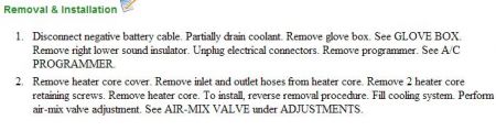

whre is the heater core located in a 1996 cadillac eldarodo

Hi there, see text foe heater core removal, sorry but there are not pics on file for this job.
