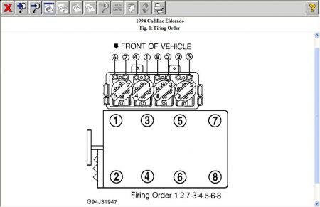

hello, my problem is on the engine its self the #'s are(left -right)8-6-4-2 but in the chiltons guide they are 4-6-8-2 what is the correct and complete order

See below and Good Luck
https://images.2carpros.com/forum/automotive_pictures/12900_fo_64.jpg
