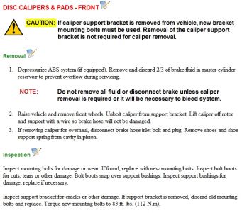

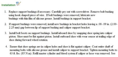

what are the steps to front brake replacement and how often should i brake bleed?
Apr 18, 2010 at 4:30 AM
BLUELIGHTNIN6
  • 16,542 POSTS
Hello and thanks for donating Below are the steps for replacing your vehicle's front brake caliper and pads. You only need to bleed the brake system after repairs have been made or anytime you suspect air has came into the system
