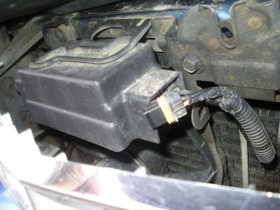

i figured out the problem, it was bad distributor. i have 2 new problems, cooling fan does not kick in by it self but works if i turn on a/c and the brake light does not go off, ive checked brake fluid and e-brake released.

The cooling fan control module needs to be tested to see if it working as it should. So check the orange wire going in for power and we will take it from there. The fan module is on the bottom of the upper radiator support on the right (passenger) side.

i beleive i found the cooling fan module, and there is battery voltage at the connector with orange and black wires.

Ok so tell me how many fans do you have 1 or 2? Do they work if you turn on the A/C? Yes that looks like the cooling fan module. Get back to me so I can walk you through the proper test thanks.

there is 2 fans, one on the back of rad and one in front. fans work when i turn on a/c.

Ok check the ohms of resistance between the black wire (next to the orange wire) and ground let me know what you find. Then after you check that I need you to back probe the green wire and then run the car and get up to temp (don't let it over heat) and with you volt meter hooked up do you get power there when up to temp where the fans should come on? Then check the brown wire. If so then the control module is bad. If you get no power then we need to check the engine control module and the body control module to see which isn't sending the power. Let me know what you find.
