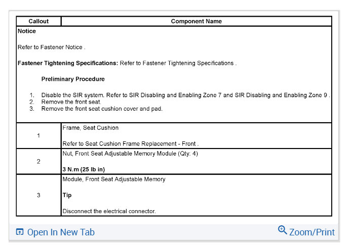

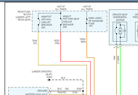

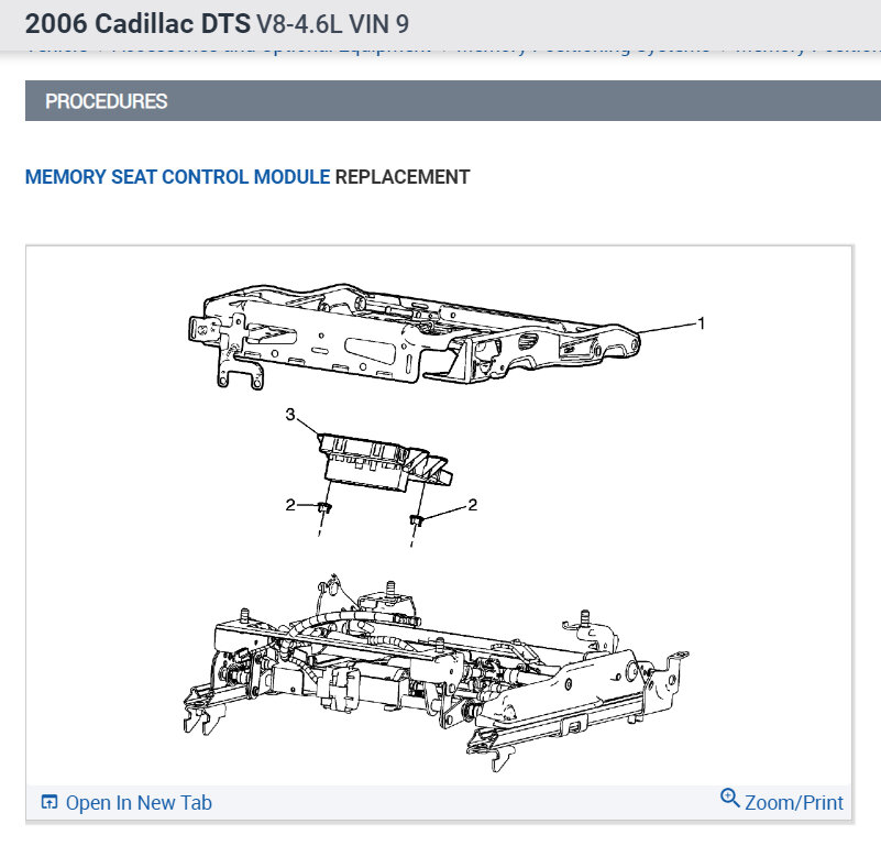

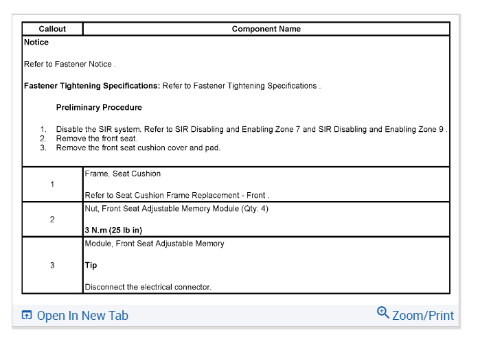

The first thing I would do is check the fuses for the seat here is a guide to help and the seat wiring diagrams below so you can see how the system works and which fuses to check.
If the fuses are okay it sounds like the seat positioning module has gone out. Check out the images (Below). Please let us know what happens.
