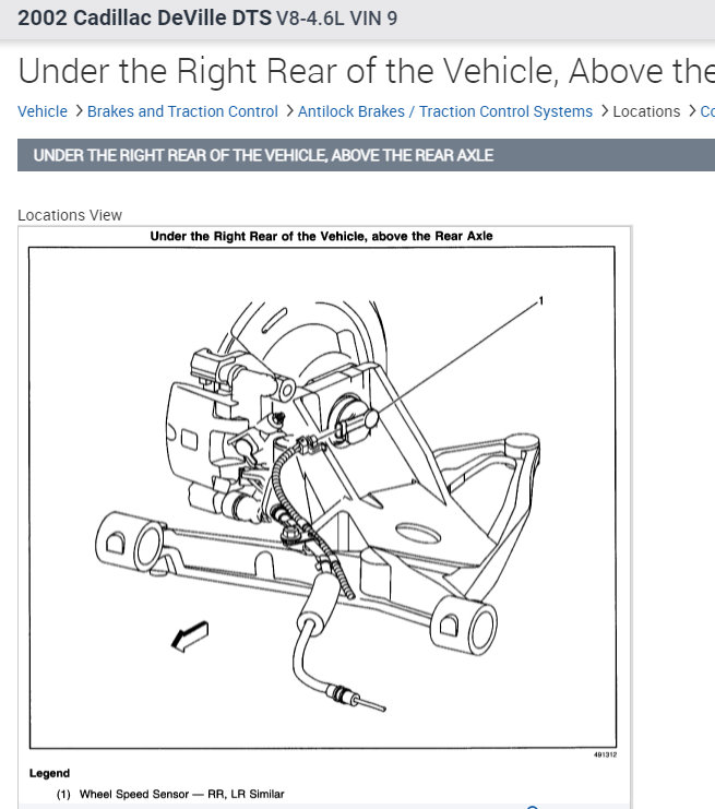

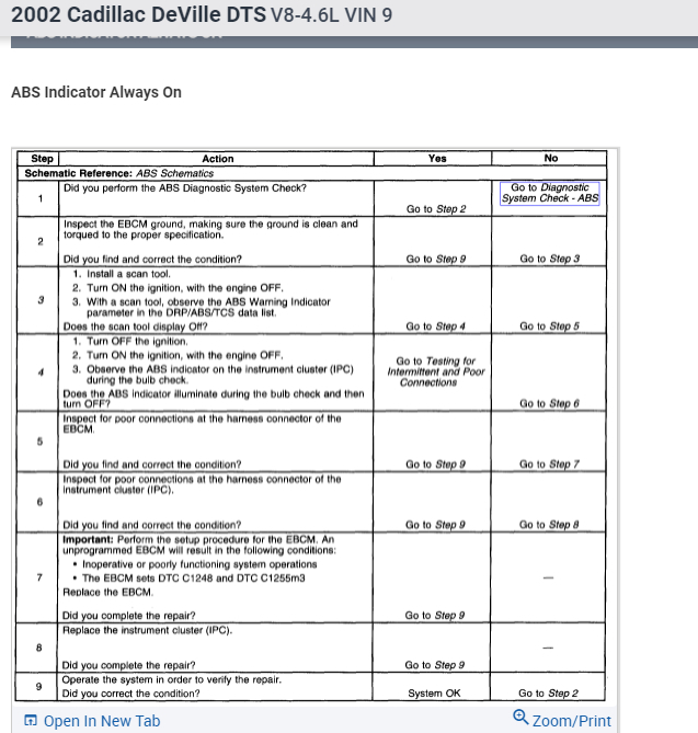

The stabilization system is not working and the light is on
Mar 13, 2010 at 5:53 PM
SQM
  • 6,383 POSTS

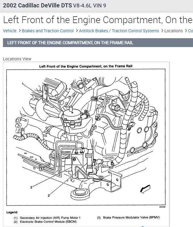

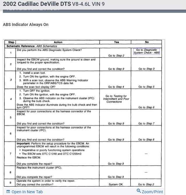

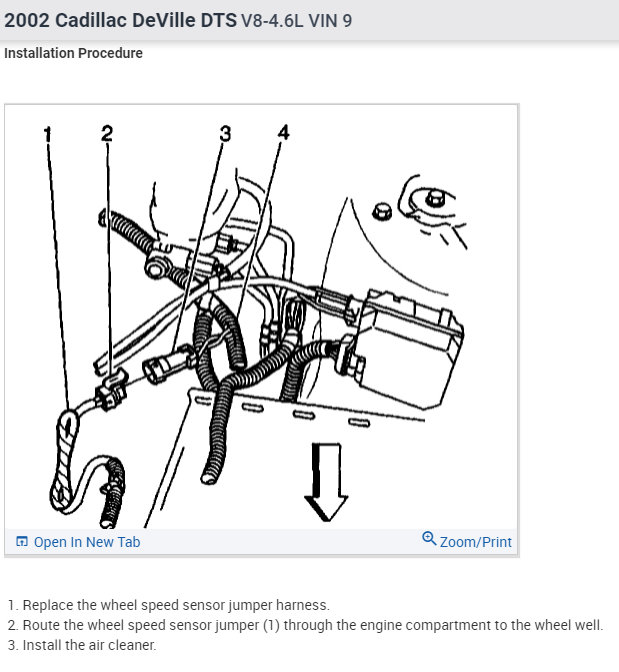

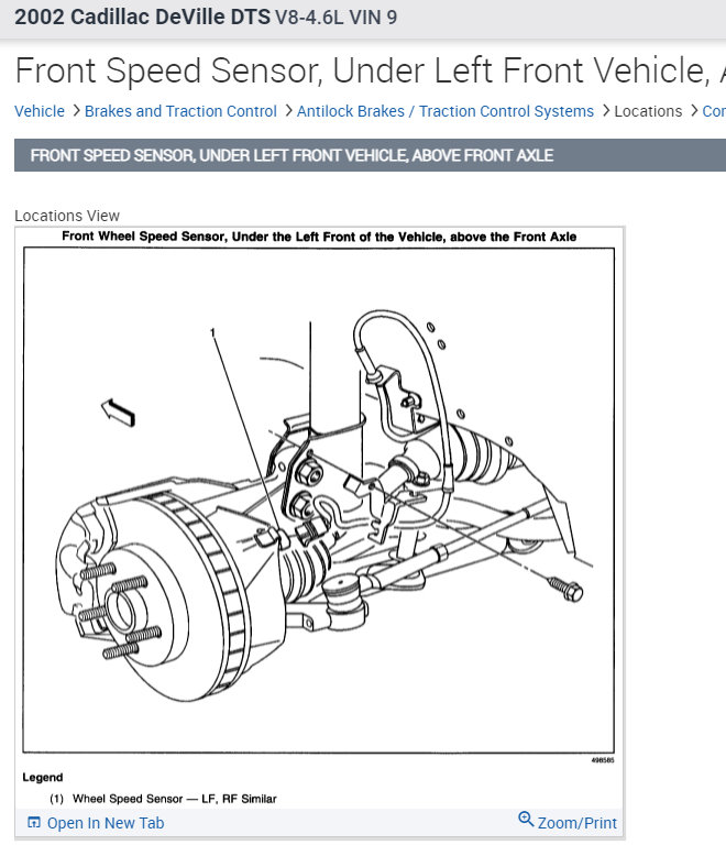

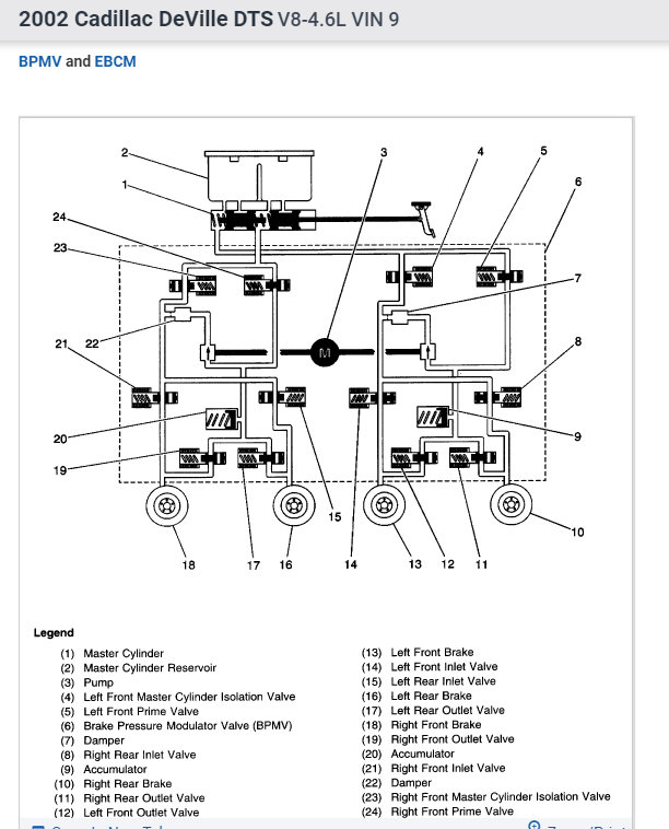

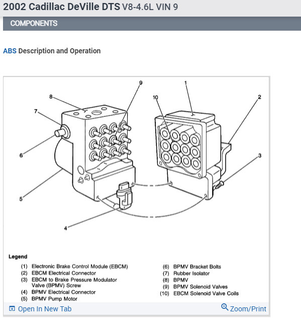

The stability system light gets illuminated when the on-board diagnostic system detects issues with any of the components within the system.
The stability control and the ABS system works together, so if there is an issue with the ABS system the stability control will not function.
It could be due to a bad ABS sensor on one of the wheels or issue with the electronic brake control module (EBCM).
Best course of action would be to have the vehicle scanned for ABS codes. This can help narrow down the possible reasons.
Here is a helpful video on ABS scan:
https://youtu.be/rTtAnsOlZU4
Take a look at this guide, it covers the common issues:
https://www.2carpros.com/articles/abs-warning-light-on-easy-repair-guide
